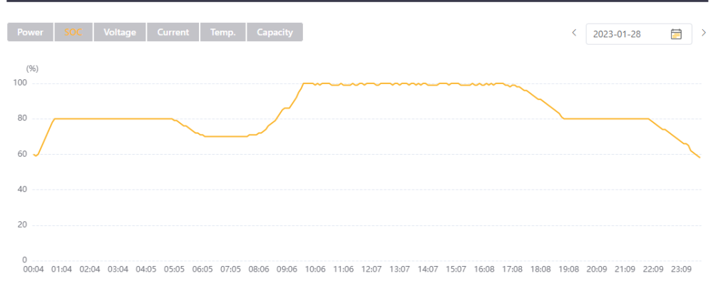

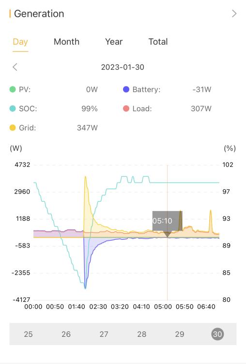

BdJ Posted January 29, 2023 Author Share Posted January 29, 2023 On 2023/01/27 at 11:29 PM, BritishRacingGreen said: I am sure @Leshenwill be able to check your basic settings, he has done a number of Sunsunk/Hubble systems. Thanks for tagging. Started noticing a new trend, might be the battery or wrong information given from the inverter. The battery is only charging to 99%, last few charges, it only reached 97%. Quote Link to comment Share on other sites More sharing options...
BdJ Posted January 29, 2023 Author Share Posted January 29, 2023 Now, sadly, i'm only seeing a 96% SOC. I've reset the battery and inverter, no success. Quote Link to comment Share on other sites More sharing options...

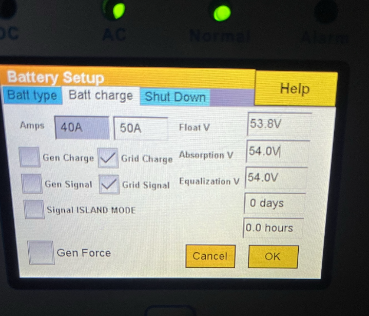

TimCam Posted January 29, 2023 Share Posted January 29, 2023 On the "Battery Charge" tab set: Float = 52.6V Absorption V = 53.6V Equalization V = 53.5 V My Hubble's still have a SOH of 100%. BdJ 1 Quote Link to comment Share on other sites More sharing options...

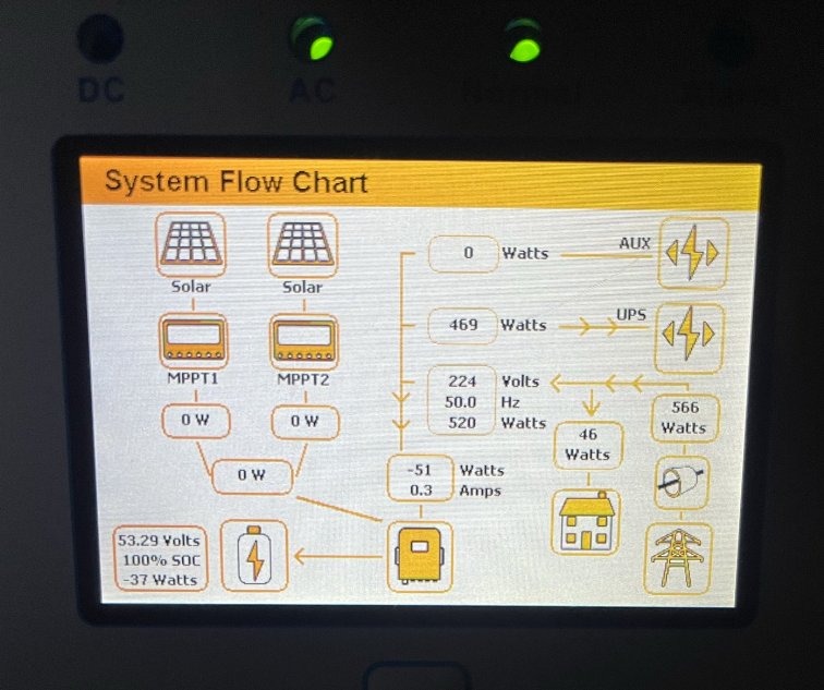

TimCam Posted January 29, 2023 Share Posted January 29, 2023 (edited) My system has just come out of a charge cycle after load-shedding so batteries are 100%. Pack #3 is my newest Hubble, and is 120A. Edited January 29, 2023 by TimCam Quote Link to comment Share on other sites More sharing options...
BdJ Posted January 29, 2023 Author Share Posted January 29, 2023 12 minutes ago, TimCam said: On the "Battery Charge" tab set: Float = 52.6V Absorption V = 53.6V Equalization V = 53.5 V My Hubble's still have a SOH of 100%. Thanks! I’ll quickly set it and monitor the outcome Quote Link to comment Share on other sites More sharing options...
BdJ Posted January 29, 2023 Author Share Posted January 29, 2023 (edited) 8 minutes ago, TimCam said: My system has just come out of a charge cycle after load-shedding so batteries are 100%. Pack #3 is my newest Hubble, and is 120A. I see yours shows no power drawn, mine keeps a 40-60w power draw going, even when fully charged The unit is a week old, so not quite sure if it’s the cells trying to balance still? Edit, how are you getting the cycles output, or is that only for certain wifi dongle’s and apps. I’ve got the sunsynk wifi adapter Edited January 29, 2023 by BdJ Quote Link to comment Share on other sites More sharing options...
BdJ Posted January 30, 2023 Author Share Posted January 30, 2023 Well it’s not 96% anymore, neither is it 100% Quote Link to comment Share on other sites More sharing options...
JamesF Posted January 30, 2023 Share Posted January 30, 2023 I use a SunSynk 5Kw with a Greenrich battery, and it floats between 99% and 100% (grid or solar.) It must be something to do with the BMS floating - not over charging. It only happens at 99-100% Check my batter below - I set different SOC minimums for time of day (to reduce my reliance on grid as much as possible.) When set to 80% SOC, its perfect. When set to 100% - its hovers between 99% and 100%. BdJ 1 Quote Link to comment Share on other sites More sharing options...

BdJ Posted January 30, 2023 Author Share Posted January 30, 2023 Now it's back at 100% Seems the Sunsynk and Hubble have some issues talking to each other? Quote Link to comment Share on other sites More sharing options...

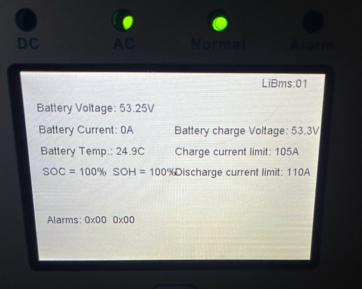

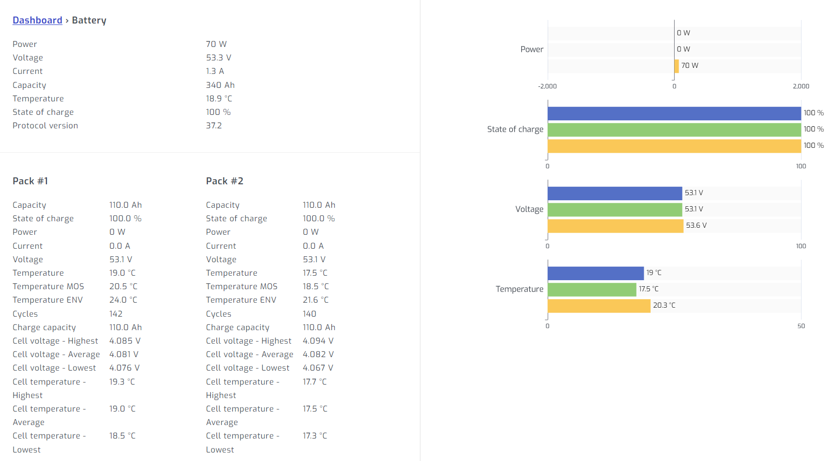

system32 Posted January 30, 2023 Share Posted January 30, 2023 (edited) With Hubble, the BMS will prevent charge when going from 100%->95%. This can be seen on the LiBMS screen: In the first image, the battery went from 100% -> 99% (due to no PV and load), the BMS tell SunSynk "Charge current limit: 0A", which prevents charging. This changes at about 95%. -- The correct values for AM2 are at https://www.hubblelithium.co.za/sunsynk -- You might want to consider lower values: Values like 10%, 15%, 20% I use 5%, 7%, 10% Shutdown: Inverter goes into standby mode Low Batt: Inverter stops using battery [Load will go off] Restart: When charging, AC output will resume when this is reached. -- The biggest issue with AM-2 is to ensure you have working firmware. Some batches had firmware where the SoH went down quickly, was fixed with a firmware update. -- TIP: PBMStools is quite useful utility to see individual cells. Use the RS485/modbus -> RJ12/RJ11 cable (same as Solar-Assistant) -- >However, all that said, I'm not sure if my settings are correct? The battery's DIP switch has been set to 1 on, 2,3,4 off. Download the AM-2 manual from here: https://www.hubblelithium.co.za/am-series Edited January 30, 2023 by system32 BdJ 1 Quote Link to comment Share on other sites More sharing options...

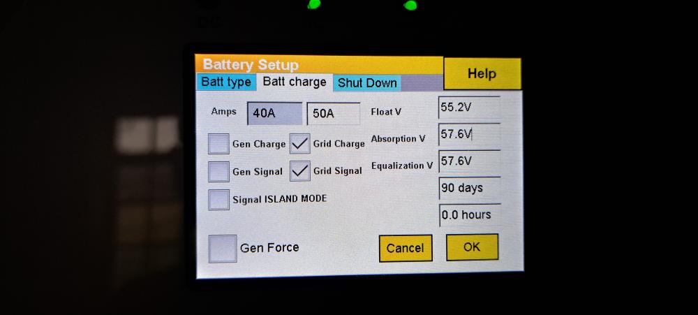

Matthys Koch Posted January 30, 2023 Share Posted January 30, 2023 I am a bit confused... my Hubble AM2 was installed mid December last year. I checked the Voltages when I saw the threads with the SOC probelems. I asked my installer why my settings differ from the Hubble website. He said that the BMS configures those voltages. My current Voltages are as follows: Float V: 55.2V Absorption V: 57.6V Equalization V: 57.6V Discharge Amps: 120A State of charge has been stable since first installed and the SOH is also still at 100%, so I hope it stays there! Sorry if this is a bit of a hijack... Regards, Matthys BdJ 1 Quote Link to comment Share on other sites More sharing options...
BdJ Posted January 30, 2023 Author Share Posted January 30, 2023 59 minutes ago, system32 said: With Hubble, the BMS will prevent charge when going from 100%->95%. This can be seen on the LiBMS screen: In the first image, the battery went from 100% -> 99% (due to no PV and load), the BMS tell SunSynk "Charge current limit: 0A", which prevents charging. This changes at about 95%. -- The correct values for AM2 are at https://www.hubblelithium.co.za/sunsynk -- You might want to consider lower values: Values like 10%, 15%, 20% I use 5%, 7%, 10% Shutdown: Inverter goes into standby mode Low Batt: Inverter stops using battery [Load will go off] Restart: When charging, AC output will resume when this is reached. -- The biggest issue with AM-2 is to ensure you have working firmware. Some batches had firmware where the SoH went down quickly, was fixed with a firmware update. -- TIP: PBMStools is quite useful utility to see individual cells. Use the RS485/modbus -> RJ12/RJ11 cable (same as Solar-Assistant) -- >However, all that said, I'm not sure if my settings are correct? The battery's DIP switch has been set to 1 on, 2,3,4 off. Download the AM-2 manual from here: https://www.hubblelithium.co.za/am-series Highly appreciate this feedback So keep the volts the same, across Float, Absorb, and Equaliz, gothca. Battery setup can go lower, will amend as per your suggestion. 10, 15, 20% Quote Link to comment Share on other sites More sharing options...
TimCam Posted January 30, 2023 Share Posted January 30, 2023 19 hours ago, BdJ said: I see yours shows no power drawn, mine keeps a 40-60w power draw going, even when fully charged The unit is a week old, so not quite sure if it’s the cells trying to balance still? Edit, how are you getting the cycles output, or is that only for certain wifi dongle’s and apps. I’ve got the sunsynk wifi adapter Every now and again the batteries send +- 37 W upwards to the inverter, even with grid and solar available, don't worry about that, it's normal. The Battery SOC can also vary between +- 96 - 99%. Only at the end of load-shedding at night when the batteries are fully charged, will it be 100% for a while. The cycle count is shown by the aftermarket Software I use, called Solar Assistant. https://solar-assistant.io/ Quote Link to comment Share on other sites More sharing options...
BdJ Posted January 30, 2023 Author Share Posted January 30, 2023 2 hours ago, TimCam said: Every now and again the batteries send +- 37 W upwards to the inverter, even with grid and solar available, don't worry about that, it's normal. The Battery SOC can also vary between +- 96 - 99%. Only at the end of load-shedding at night when the batteries are fully charged, will it be 100% for a while. The cycle count is shown by the aftermarket Software I use, called Solar Assistant. https://solar-assistant.io/ See mine keeps a 20-60 W constant feed? Which feels strange, or I don't understand these Hybrid inverters yet. Coming from an Axpert type inverter, still loads to learn Quote Link to comment Share on other sites More sharing options...
system32 Posted January 31, 2023 Share Posted January 31, 2023 On 2023/01/30 at 4:14 PM, Matthys Koch said: I am a bit confused... my Hubble AM2 was installed mid December last year. I checked the Voltages when I saw the threads with the SOC probelems. I asked my installer why my settings differ from the Hubble website. He said that the BMS configures those voltages. My current Voltages are as follows: Float V: 55.2V Absorption V: 57.6V Equalization V: 57.6V Discharge Amps: 120A State of charge has been stable since first installed and the SOH is also still at 100%, so I hope it stays there! Sorry if this is a bit of a hijack... Regards, Matthys AFAIK, your installer is correct, the BMS controls the inverter charge / discharge etc. This can be seen in the LiBMS screen. BdJ 1 Quote Link to comment Share on other sites More sharing options...
