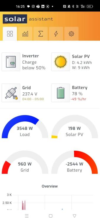

August 29, 20232 yr When I set my system to "Export to CT" and the turn on the geyser - when the grid is on, the system shows the geyser usage however it is pulling from the Grid and my battery. Is this correct? I was hoping to see the geyser usage (for monitoring correct usage) but having the geyser run off the grid/pv and NOT use my battery:
August 29, 20232 yr Apologies all - resolved this by making sure battery is charging while Geyser is on:
