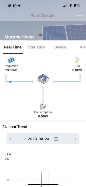

Deye Inverter not showing House Consumption when set to Zero Export to CT
I have a Deye 5kw hybrid inverter with panels and a 5kw battery.
 I also have the solarman ios app.
My inverter is set to Zero Export to CT as recommended by installers but in that setting the inverter and the app both show house consumption as 0.
When I change to 'Zero Export to Load' it then does the live house consumption but then the PV wont power the non-essentials which I want them to.
Anyone exprienced this and know a solve?
Also my solarman smart app show the battery on the dashboard.
Anyone know how to keep Zero Export to CT and still see consumption?

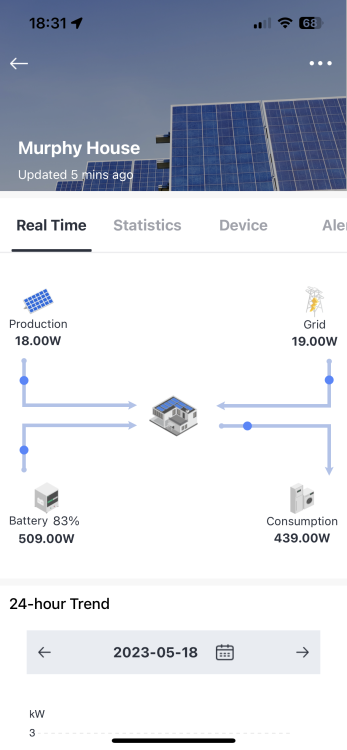

I figured out how to get the battery to show on the home page dashboard!!!
You need to go into Plant Info and change the System type to Storage instead of Self consumption. Click yes and then done and it will then show up.
Stoked!
