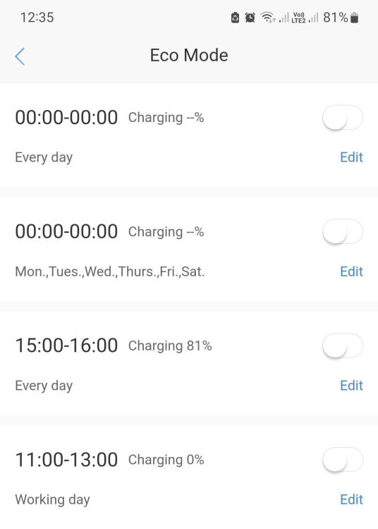

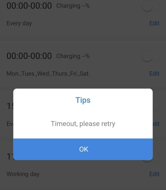

May 14, 20233 yr I am able to control everything that is controllable for me ES when I'm at home. However, there are times when control when away from home would be useful. Mostly what I want to do is to set up eco mode in order to get some charge into the batteries. Some forumites reported that this was possible via a "configure" button in the SEMS app. It turns out that you need an installer account on SEMS to get that button. I applied for and got this access. But now I find I still can't get what I want. In fact things have actually got worse. I get the configure button. I tap it and I get a disclaimer. Then I get the safety code settings. I can then tap "mode", "working mode" to set the inverter into eco mode. That gives me this The time slots shown are correct, but everything is shown as turned off. One should not be, but in fact SEMS has turned them all off. OK... not yet the end of the world, but if I try to change anything to do with any of those four sets of settings I get this... And so apart from the initial disabling of all the settings (which I don't want), I am unable to set anything up and change it. When I get back home I can set everything the way I want it, but I could do that already. So what's the point? Is anybody actually able to do this? Can you advise me please? Checkcode is 038478 Firmware is 1212113
May 14, 20233 yr Author It seems to me that I need a proper VPN set up. Then I can connect the phone to the VPN, and use PVMaster/SolarGo as if I were connected to the LAN at home.
May 14, 20233 yr Author 43 minutes ago, Bobster. said: The time slots shown are correct Actually they aren't. They should be 9:00 to 11:00 on Sundays 00:00 to 00:00 every day 15:00 to 16:00 every day (the one that should be on) 17:00 to 18:00 every day So only one of the time slots shows correct times and days, and it is off when it should be on.

June 15, 20233 yr Author I certainly can connect to the inverter remotely and I now get the "configure" button. But I can't actually configure anything, and, which is worse, I lose certain settings that I previously made and saved. I need to engage with Goodwe again, but these days it's like pulling teeth.

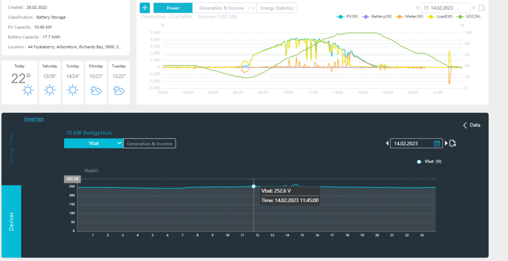

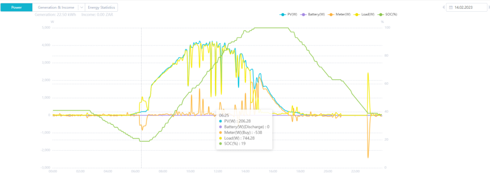

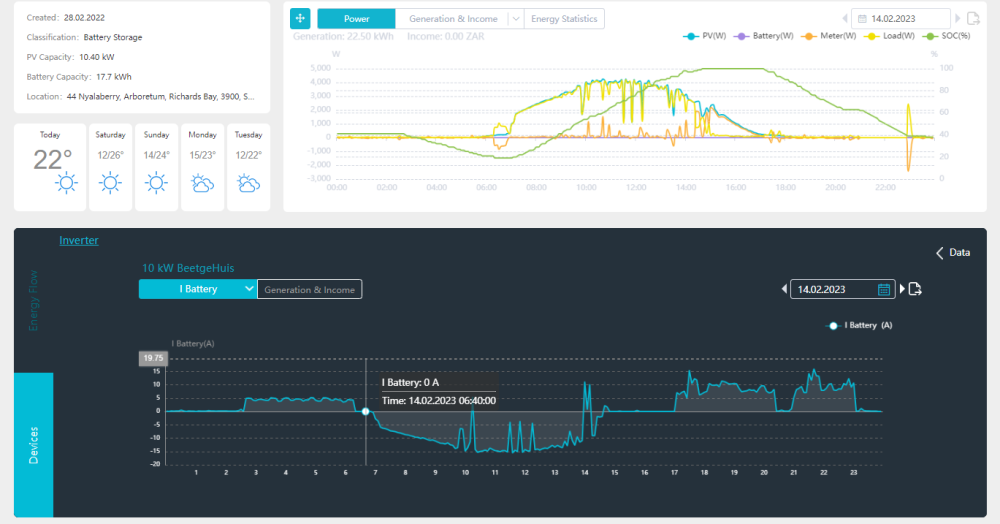

June 23, 20233 yr It seems that Goodwe SA is of no technical support. I have a problem where Sems Portal indicates my LOAD (wattage) higher than what it actually is and the wattage that it is higher is missing on my charge going to the battery. I will be charging the battery at 2400 W but the graph only indicates 1200 W. The load will indicate 5000 W but the actual load is only 3800 W. There seems to be some calculation error on the server or from the server ( data from server). This problem started in April after the server went down with some ridiculous figures on the data. All the data from the past is effected and makes all the graphs and data useless. Here is an example: This is data from the past. It used to be correct but is now all useless. Look at the yellow line. That is the load. The load increases with the pv generation. Battery is charging because SOC is going up but with 0 Watts doing the charging. What the hell is going on. I am trying to get technical support from Goodwe SA but they cant see the problem. I assume they did not take math's as a subject at school. This is the graph with Current to battery. Next picture is Voltage to battery. ( Voltage is correct 250V ). Do you guys see the problem. The purple line on the top graph indicates 0 Watt charge to the battery but the current and voltage indicates that the battery is charging. How do I get SA support to get this sorted out. I'm Gatvol.
