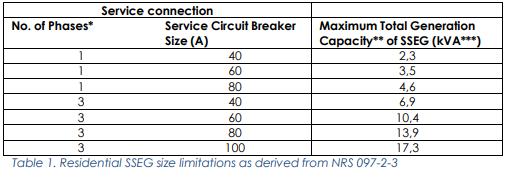

@plonkster am I reading this right?
Beaker is 80amps, house is single phase, so I can have a max of 4600VA generation?
** Generation Capacity refers to the total output capacity of the generator.
For PV systems in particular, this refers to the maximum output of the inverter as limited either by hardware, or by software settings. The system designer/installer will provide guidance here.

Breaker is 80amps, house is single phase, so I can have a max of 4600VA generation?
It seems you have indeed retained the skill of reading tables :-P
It agrees with what I remember, that single phase houses are limited to 3.5kw, clearly based on the average 60A breaker I've seen in most houses.
I wonder how they got to those figures. 80A should carry about 19200VA.
It's not based purely on the volts multiplied by the amps. There are other factors involved which I don't understand yet, that means the cable doesn't necessarily carry the same current in the other direction. Some of that current is also consumed on your end, so by injecting it on the other side of your own 80A breaker you raise your site-capacity from 18kw to 28kw (if we assume 10kw). I half suspect this is to protect people against themselves. Otherwise you get situations like that one I saw up North where someone paralleled 3 x 15kva units on a single-phase house...
Edited to add: I recall a case of someone with two 5KVA Axperts who got into trouble because it allegedly exceeded the 3.5kw allowed capacity. For a unit that is not grid-interactive, you are not overloading any local wiring. When in inverter mode (total capacity 10kw), the grid is disconnected, so there is no additive effect going on.
Please explain? This doesn't make any sense to me at all. With something like an Axpert, this isn't possible. Or, rather, I cannot see how it would be possible.
With a Grid-tied unit, you cannot get more ampere than it can generate, and even if the Grid-side has an 80A breaker, the house would only consume what it needs.
Correct. So in that particular case that I remember, where the home owner was told that was illegal, in that case the officials were wrong. At least technically speaking.
Hypothetical situation. Say you have a 10kva GTI running full tilt, that's an extra 40 amps. Let's say you have a 40A breaker on that line. Your main breaker is 80 amps. This means there is now a total capacity on the site of 120 amps, without either of the breakers tripping. I'm not sure if that is the reason, it was just one reason I thought of. Give me time though, this is intriguing enough to spend some time on.
OK, I found something, and this makes some sense. It has to do simply with the fact that the distribution network was designed to be uni-directional. If you think about the good old iron transformer you might have salvaged out of an old radio in high school, and then you ran it in reverse and had competitions seeing who could hold on longest... (well, we did... used to start with a big circle and the losers got kicked out making the circle smaller until there was just one guy trying to be Rambo). In any case, you may remember that the transformer didn't really work that well in reverse. Same thing on the distribution network: They are not designed to be back-fed, so they can only handle a lower power level.
Of course the power you feed in does not actually go up the chain through the transformer, not usually. It will more likely be used by other houses in your street that are on the same phase. But how many houses are there in YOUR street? On your phase? How do you make a rule that applies to all situations?
So simply, this rule is just the simplest safe point that gives you automatic approval. You can do more, but then you got to involve the planning department of the distribution company.

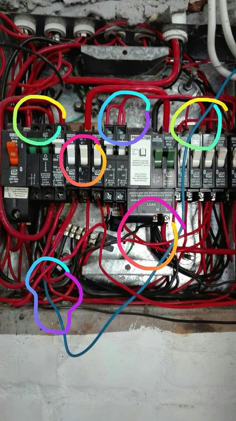

In terms of a modern DB I cannot really see how this could easily happen. You may have 120 amps total available now, but that is on the busbar at the top of that long row of breakers that feed your lights and plug connections. It still has to pass through each individual breaker, which will be limited to 20A, 10A, and so on. It is actually not possible to overload any part of the installation, as presumably both are sized for the current they will carry. The only bit that has to handle the whole 120A is that busbar at the top of your DB that feeds the breakers.
Now I've seen distribution boards where this is an actual copper busbar, and then I've seen the kind looped with copper wire. One has to consider Kirchoff here, if you daisy-chain them from left to right, and you have 10 breakers of 20A each, then that first link has to be capable of handling 200A. Now if you know the main breaker is rated 60A (as in my house) or 80A (as in your house), then you can save money by not rating this to 200A. And you might be sorry later. I'm still not convinced this is the main reason, just an educated guess.
You'd be amazed how contractors get this wrong. See attached picture by a sparkie friend of mine. Do you see it? Top middle, looks like two breakers chained together with a wire that's probably rated no more than 10A or 15A. Now look at the breaker ratings...
