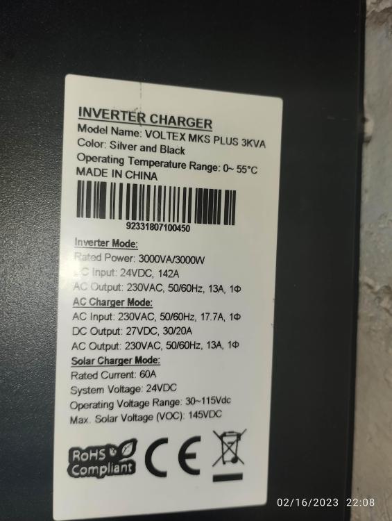

if possible, could you post a photo of your inverter specs? im trying to wrap my mind how you have 2000w odd PV connected to the Plus model that can only take 1500w according to my findings on google. your system is pretty much what im after, only issue i have currently is the 600w capability of my current inverter. hence me lookin at upgrading. something with SUB function, to benefit even more from the panels.
You can over size Wats but never volts  but with my solar setup I have 1 string facing the afternoon sun so I will never get the full 2060w  this gives me a longer day but still on sunny days under load the controller does limit to 1550wats .
On specs rated amp is 60amp so about 1500wats
You can go 800wats panels  on your inverter and should not be an problem .
You said you have the Esener lithium and with lithium you must never use equalize mode that's only for gel and lead batterys
