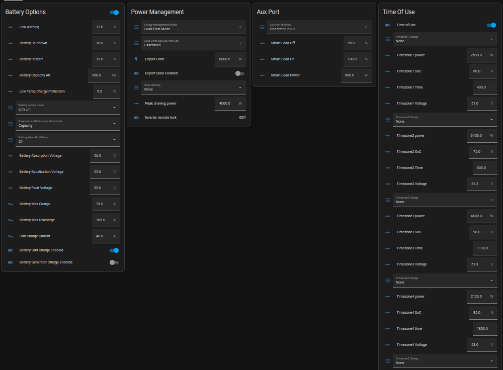

Hi guys, I’m awaiting installation of my 8kw deye and also exploring what options exist (besides SolarAssistant) to manage parameters remotely.@Sc00bs, did you manage to sort this out?
