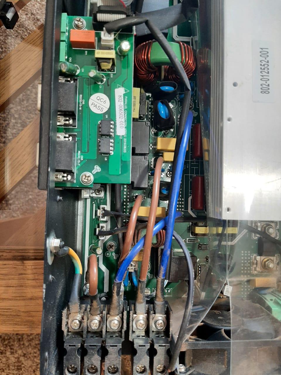

If your machine is not under warranty  open it up and take a birds eye view image of the internal then I can identify the fuse. It will tell if if its the same as the MAX8KW.

1 hour ago, Gromit said:
Thanks, your images are very clear, but I dont see a big fuse in the bottom left hand side, which I normally expect on these larger machine. There could be a thermal breaker, can you see one on the bottom panel.? It looks like a small breaker with a round reset button.
Unfortunately it appears that your machine is a clone of Axpert, and cannot relate to the pcb modules as shown.

I hate to say it, but it may not be worth repairing.
I see signs that they are really skimping in the design; for example, the battery terminals look like the same ones I used in a past job, and those were rated at 80 A. A 6 kW inverter is going to have to pull 120 A plus losses from 48 V. If I'm right, that part is being used at up to 56% above its design current.
I see they skipped the input chokes. The relays look the same as the ones on my 5 kVA model. So those might be being used at up to 60% over their rated current.
The main transformer looks much the same as my 4 kW model. And these are just the things I spotted from a quick look at your photos.
So it looks to me that they took a 5 kVA 4 kW design, and called it a 8 kVA 6 kW model, perhaps beefing up a few parts here and there, but not everything that needed beefing up.
I'm actually amazed that it lasted the year that it did.
