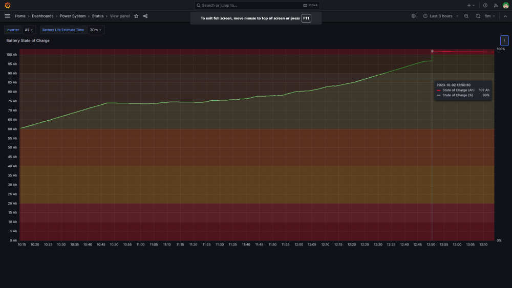

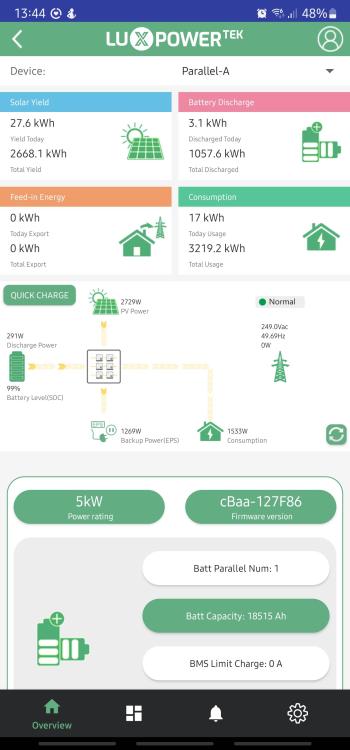

Hello everyone,
Has anyone noticed how Luxpower SNA 5000 does not have settings to limit PV charge to the batteries?
With PV Power, the inverter charges the battery to 100% resulting in multiple over voltage protection (OVP) warnings on the BMS and Battery High Voltage warning on the inverter. I thought it will use AC or Generator charge settings for PV charge but nope.
Is there a method to limit the PV charge? I want to use the battery for loadshedding only. This issue is forcing me to discharge the battery over night to avoid filling them quickly in the morning, which avoids multiple OVP warnings on the BMS. I am using an SVolt 5.09KWh 48V battery with comms working via CAN port.
This is frustrating, and shocking how this manufacture did not consider putting settings to control PV charging.

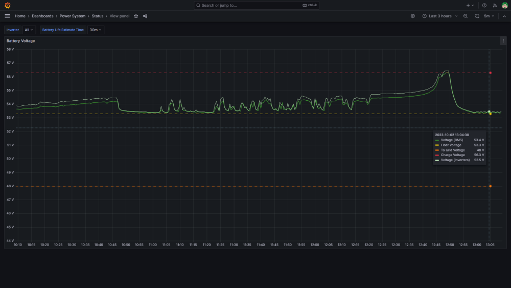

@MightyDee I have noticed a similar issue with my batteries (16 cell version), at times it's at 100% SoC with a pack voltage of around 54v and at other times its at 100% SoC with a pack voltage of high 55v (ie. 55.7v). I played around over the weekend to see if I can try pin point when or why this happens, at first I thought it was the primary battery which would end up with the lower pack voltage but that does not seem to be the case.
I know that the cell OV alarm is set to 3.60v and OVP is 3.70v, this is only released at 3.38v though.
The other thing which is a bit peculiar is that the pack fullcharge voltage is 56v which is not technically a 100% full 16 cell LiFePO4 pack.

Yes they do as the 5.09kWh is 15 cells and the 5.43kWh is 16 cells, so the voltages need to differ and they do.
54.7v / 15 cells = 3.646v which is basically a full cell.
Svolt use a Pace BMS and Hubble also use a Pace BMS - likely different Pace BMS versions though but the compatibility with inverters is likely the same.
