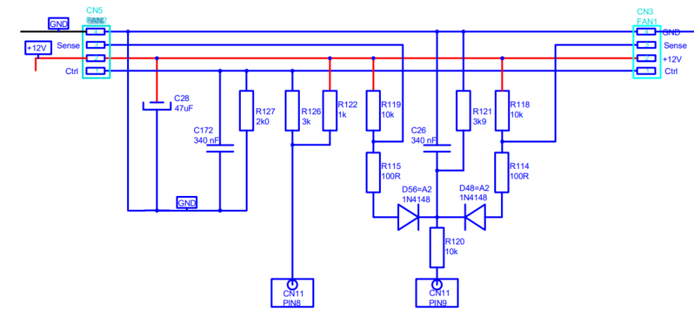

The fan circuit is remarkably simple:
Since the right hand fan works, and the fans are basically connected in parallel except for the sense wire, it's unlikely to be a hardware issue, unless it's a blown or corroded PCB track. But you swapped the two plugs, and if I understand correctly the right fan continued to work and the left stayed stopped, so it has to be the fan. Probably an open circuit coil or more likely failed driver electronics inside the brushless "DC" fan. It's really an AC fan with a DC driver circuit included.

Edit: I just noticed that I left the highlight on from my search. Under the word "CN5" is the word "FAN2". Sorry about that.
