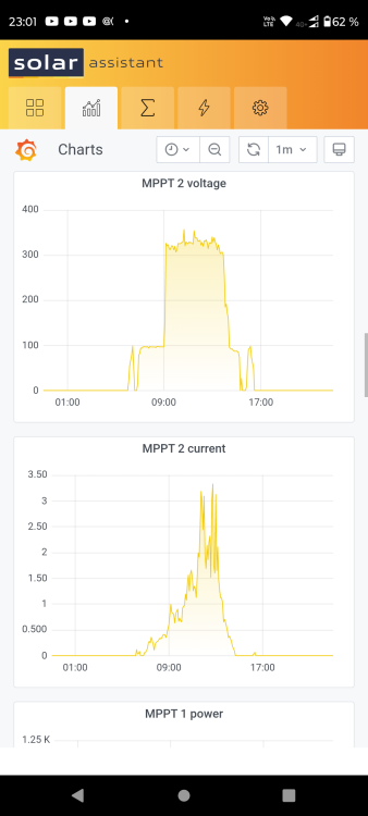

I would like to ask if any of you know how to change the parameter to fix the 90v bug.

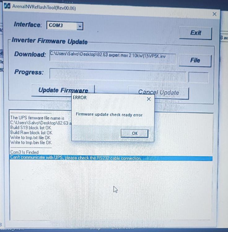

I have pushed the sailer to give me the new firmware but after the upgrade i have tested the system and is look like the issue with this 90 v 0,50 ampere is not solved.
So they releise only the firmware to solve the battery comunication issue, i think but i am not sure with the new pylon.

I solved it with the official versions issued to me by the supplier Main CPU 82.60 and Scondary CPU 22.20, they were given to me by the person who purchased it Solar Power 24. I hope I have been of help to you.
