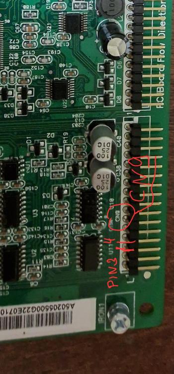

the problem is in the control board - I put another one as a test and the inverter works. Does anyone have any idea what the fault could be
My guess is the op-amp, probably the one connected to CN9 pins 3 and 4, which scales the difference between the pins for the processor to read via an Analog to Digital port, or some of the small components associated with it. There is also a small chance that it's the processor itself; if so, you really need to get a new control board.
Edit: It could also be that the +12 V or -12 V power supplies are bad, more likely the latter. Bad -12 V has caused many measurement errors in the past, usually battery voltage.
14 hours ago, Vector_ said:
can you direct me which item it is for
Whatever connects to pins 3 and 4 of CN9, which you highlighted in your photo. I don't have a schematic trace of the control board, but it's pretty easy to follow the tracks.
