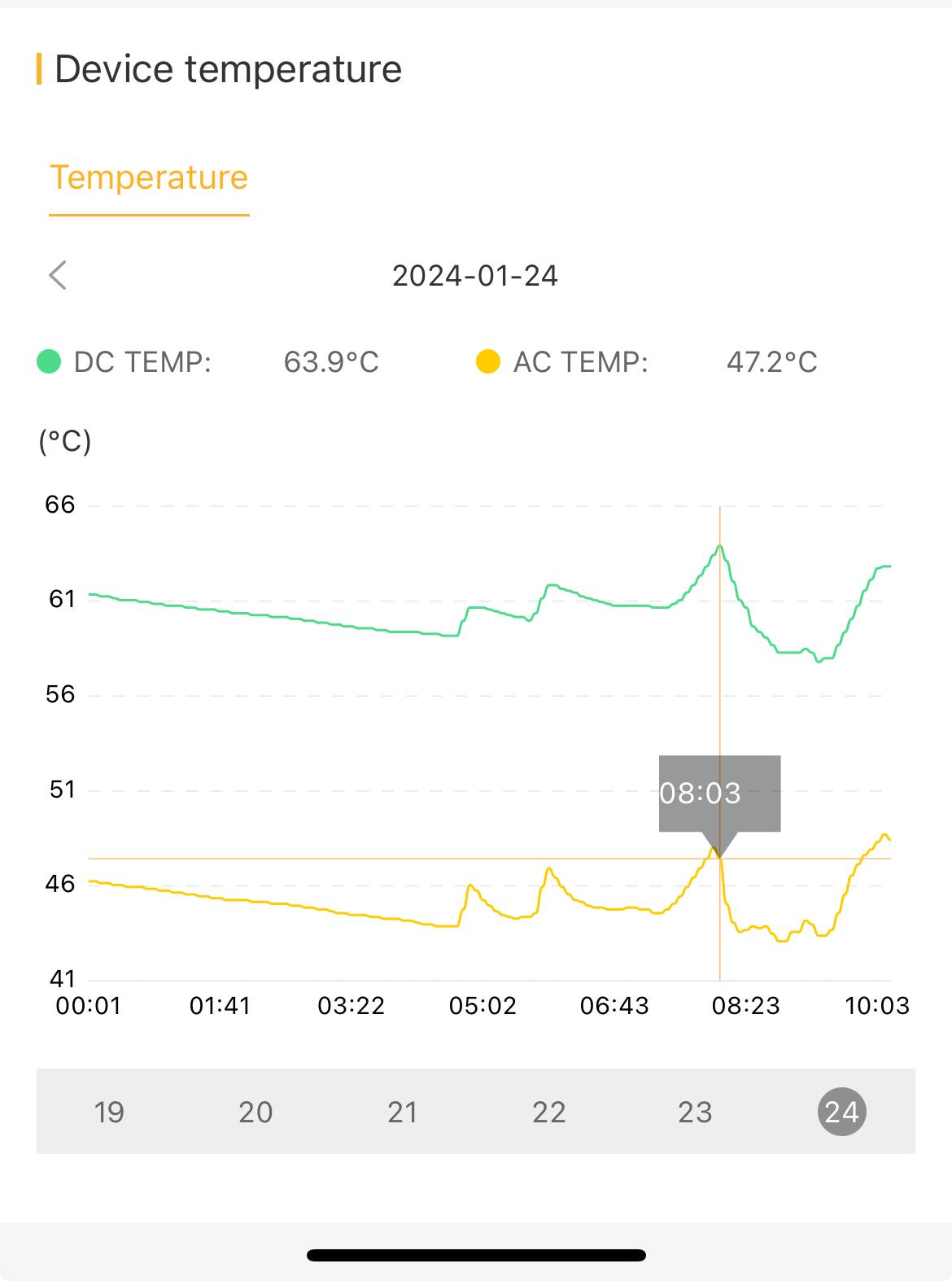

November 27, 20232 yr I am getting confused regarding what operating temperatures my Inverters should be at. I am running sun5kva hybrid inverter which is documented to operate 40~60 ºC, >45 ºC Derating. this is from the Datasheet. Now when you look at the inverter readings there is two temp readings. DC and AC. which one should be kept at 40-60Deg? I see the AC temp is regulated and inverter internal fans kick in when this goes over 60deg. However the DC temp goes over 75deg. can someone advice which is important and should be within 40-60Deg? attached picture of the temp readings.

November 28, 20232 yr Author please share what you have in mind. I am seeing alot of people go that route. I logged a support query with sunsynk and they advised both should be 40-60deg. ill start with PC fans and see how that goes.
January 24, 20242 yr Author @madness_za, update on this. I put 6x computer fans to help cool the inverter. The results are amazing. I get 20% more efficiency and the inverter is always within the 45-60Deg range
January 24, 20242 yr 12 minutes ago, KB - Kabelo said: @madness_za, update on this. I put 6x computer fans to help cool the inverter. The results are amazing. I get 20% more efficiency and the inverter is always within the 45-60Deg range As a matter of interest, how exactly did you measure the 20% more efficiency?
January 24, 20242 yr Author @PowerUser I used historical data. Measured power output before the fans installed vs power output after the fans. My concern was overheating and deterioration due to high temperatures. this temp reading is before the fans. Max yield from the sun was about 5kW. . inverters After the fans were installed. I am always at 90% efficiency. over 7kW yield. and temperature is within the 45-60deg as per reading taken today.
