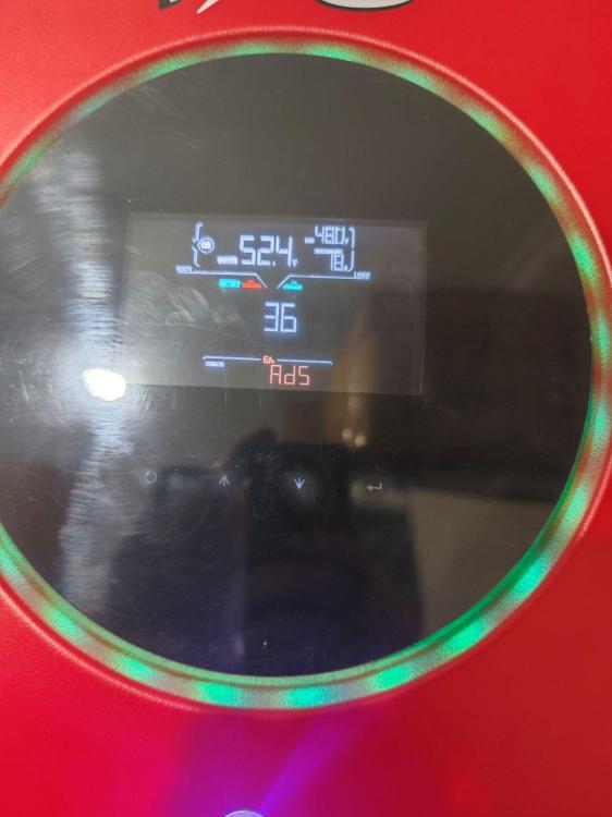

hello there ,
you seem to know a lot about the voltronic inverters and if you could help me out i would be really grateful
i have a Axpert MAX II TWIN 8KW with firmware version 54.01
i have connected a lithium battery through BMS to the inverter ..
first problem is the WIFI no longer works
second i cant change the settings in the inverter menu on the touch screen ... and the cut off voltage is in V not in percentage and i cannot change it manually
the inverter is stuck in ad5 and cant be changed
i was thinking of upgrading the firmware ... but not sure after reading the posts here i am confused
there r multiple firmware versions? different firmwares for the CPU and the touch screen?
is there anywhere a video i can use to follow for that or a step by step guide?
i work with computers and know my way around ... but the inverters is a first for me .. so don't want to brick it
any help is appreciated
Hi @rabihhatem
check the cable if it is not disconnected
If you use the BMS cable for your battery, the inverter battery settings are set by the battery BMS only. If you want to set it manually, you have to disconnect the BMS cable between your inverter and the battery.
Could you send us a picture of the inverter screen ?

hello and thanks for the quick reply
the cable is connected the 3 green lights of the wifi are on and the BMS is working correctly and communicating with the inverter.
i will attach images .
the problem is and what i found online.... is that the inverter uses the same module for bms and wifi... so only one of them can be active at a time
but even if i disconnect the bms and power cycle i can't access the menu and the inverter is stuck at the bms mode ED5 ... cant change Cut off voltage (should be percentage i think) it is stuck at 48v ... and the batteries are being completly drained ...
i have contacted the BAttery Supplier (Batteries are Dyness 14.33kw) and he said the switch from battery to utility should be done at the inverter level not the battery/bms level
the batteries are connected corretly and the DIP is 0100 on master and 0000 on slave
the inverter firmware i have is 54.01 ...
Edit. i think the correct menu number is 36 Ad5
That's "Ads" (equalisation Activation DiSabled). It's because you're not declaring a flooded battery; equalisation only makes sense for flooded batteries. So just ignore settings 30-36.
Yes, it's confusing. Yes, there are different firmwares for the main (U1, DSP) firmware and the display (U2) firmware. There is also different firmware for the touch and button removable displays, as well as the colour versus removable displays. The ability to set three settings in SoC% depends on both the main and display firmwares.
The latest 54.xx firmware I know of is 54.06, available here.
For the display firmware, I'm guessing it's 22.xx, but please post your present display (U2) firmware version to be sure. Updating both will likely fix most of your problems.
