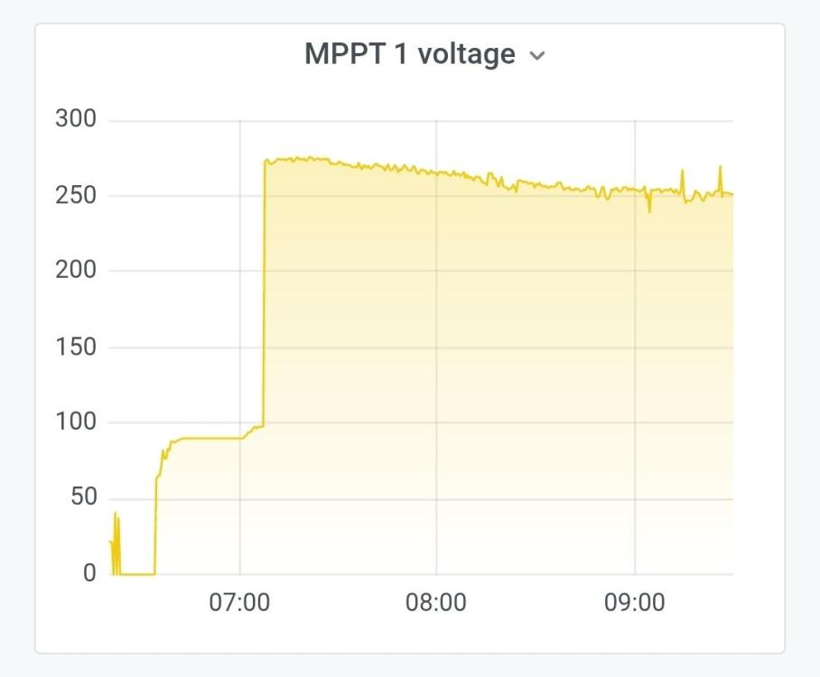

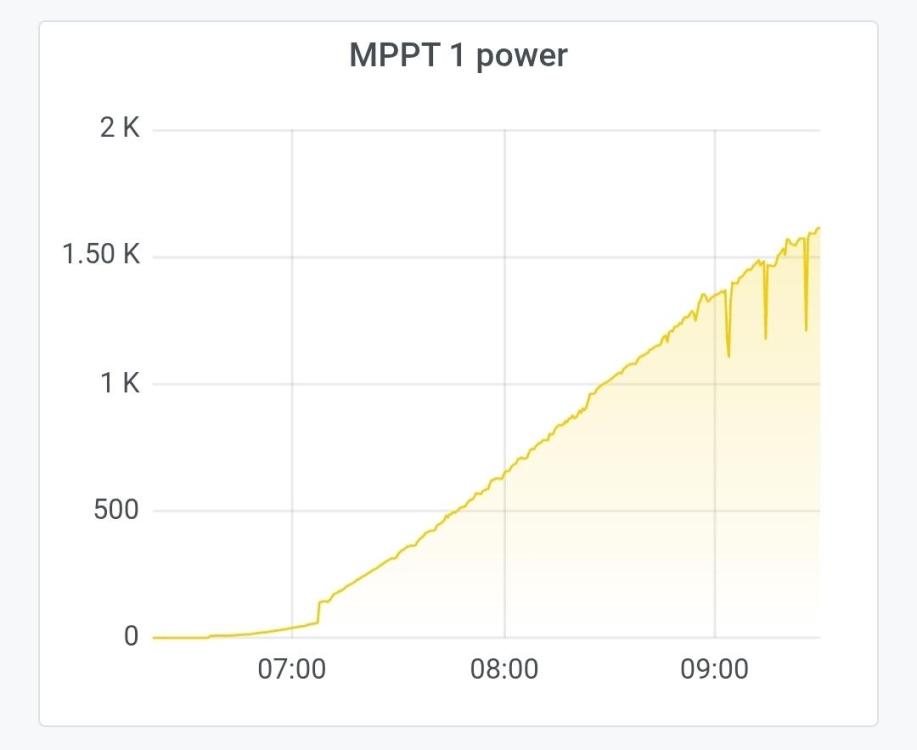

Hi,
I currently have the automatic "wake-up" mechanism working.
When the MPPT voltage is between 95 and 105 V, and the current is above 0.5 A, the MPPT input is switched off for 1 second, which causes the MPPT voltage to rise and consequently the power as well.
It's working correctly, however, I'm going to try another approach instead of interrupting the input. Although the interrupted power is around 50 W, a load interruption is never good for the electronics...
Therefore, instead of cutting off the input, I'm going to apply a momentary load of a resistor in parallel with the input, in order to simulate shading. I hope it works.
Attached are the voltage, current, and power graphs of the MPPT before and after applying the input cut-off automation.
Edited by jfmm

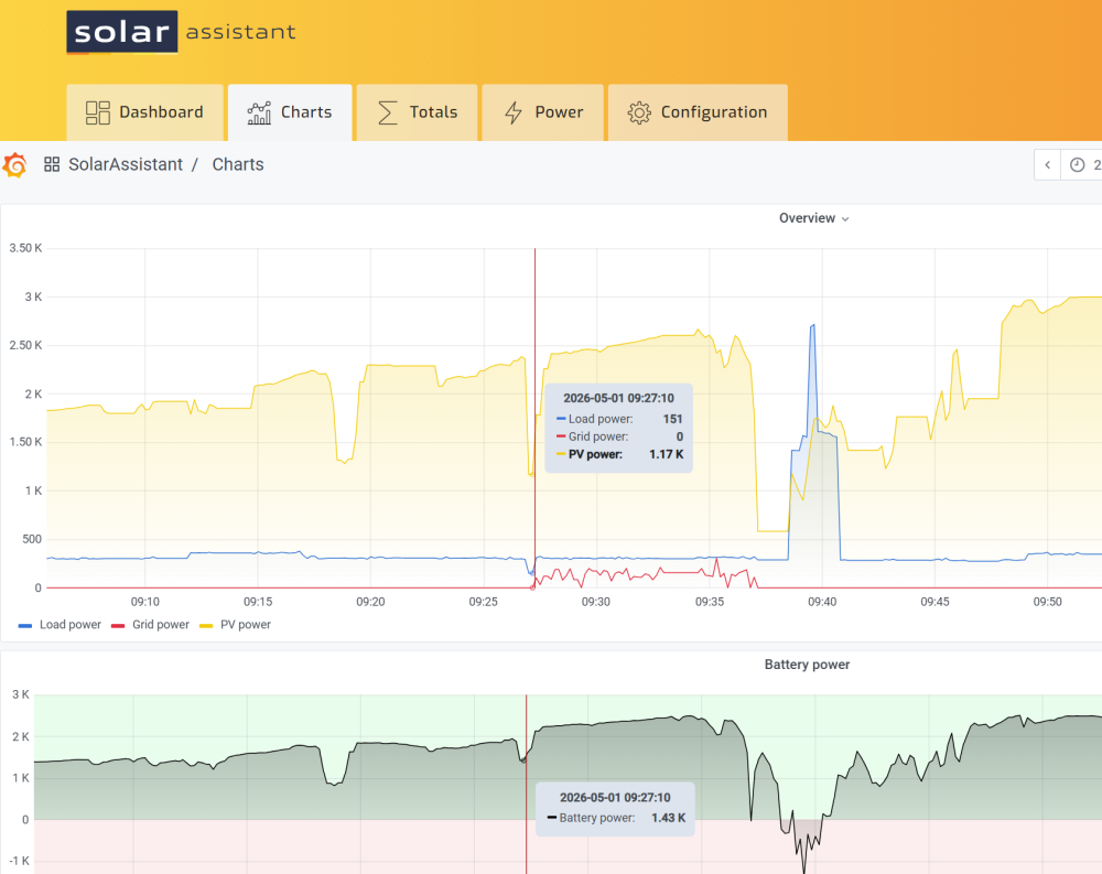

Hi,
I installed the second set of panels on the MPPT2 about a week ago.
Since then, once or twice a day, the inverter has been behaving strangely.
For no apparent reason, the inverter stops powering the loads for brief moment (maybe half a second) and stops working in off-grid mode, connecting to the grid for the next 10 minutes, after which it returns to off-grid mode.
Here's a screenshot I took from Solar Assistant at the time of one of these events.
Has anyone else experienced this or read about it to explain what the cause might be?
Thanks in advance.
Edited by jfmm
Almost all measurements seem to be going low for that one measurement period, even battery voltage and one of the temperatures. Real temperatures don't plummet tens of degrees in seconds. That suggests to me that the inverter has lost power to the measurement circuitry.
How old is the inverter?
Is your climate hot?
It may be that the power supply capacitors have dried out, and the extra panels had little to do with the change, other than shaking things up a bit. This post has details for a 5 kVA model; 8 kW models are likely quite similar, possibly with parts moved around a bit.

I don't know if you can see it in the attached image, but the event occurs where you see a small peak on the red line, which corresponds to the 10 minutes that the inverter switches to line mode.
