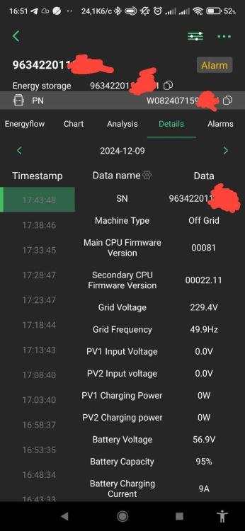

I have 8 solar panels, each with a capacity of 330 watts, connected to an 8 kW inverter and a 10 kW Felicity battery. Some time ago, I did a software update for the battery and things were good, but after a while I noticed that the charging ampere dropped to 10 amperes, and when I removed the BMC cable, things returned to normal. Is this problem due to the inverter or not?
Note that
U1 76.04
I assume you mean BMS cable.
That could be normal, if the battery was nearing full, or the cells were unbalanced.
I'm trying to decide whether your inverter is a clone. The QR code points to ags dubai dot com, and not https. Usually the QR code is "busier" (more dots because more characters). But that might just be a customisation that resellers are allowed to ask for.

The battery was not full or close to full. The charge was 70%.
Then it might be firmware related. Alas, I have no 76.xx for Axpert Max II 8 kW. But it might be the display/comms firmware, since that firmware talks to the BMS.
What is your present U2 (MCU, display/comms) firmware version?
Edit: I first assumed it was a non-twin, then realised that the sticker says Twin.
If it's 38.xx, then the latest I have is 38.11, which is well over a year old now.
19 hours ago, ahmad almawal said:
U2: 39.06
Duh! If course, it's a Max II, so it will have 39.xx not 38.xx display firmware.
The latest I know of is 39.27, much more recent than 39.06, and available from the link below. Max II displays use the same firmware as VM IVs.
