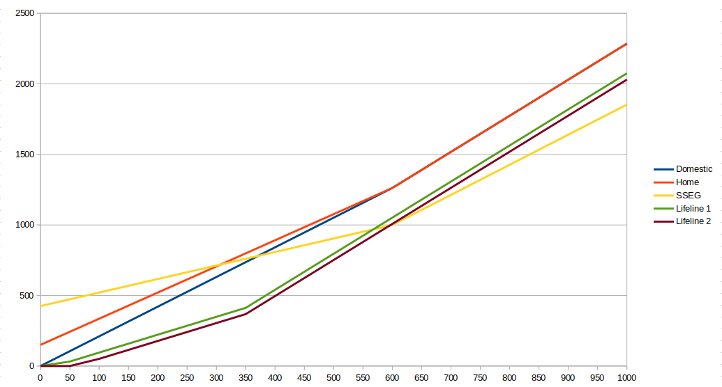

Let me explain it with a picture. KWh on the X axis, cost in ZAR on the Y axis.
For most people that will install solar, the blue line is not available. The choice is between the red and yellow lines. The Yellow line includes a rebate that is not visualised here, in other words, it is possible to pull the yellow line closer or lower than the red one. For anyone using north of 500KWh a month, there is a very good chance that you'll benefit from being on the SSEG tariff.
I wish I had this idea earlier... just plot it. I suppose that's about as close as you get to proving just how ruthlessly fair they are.
