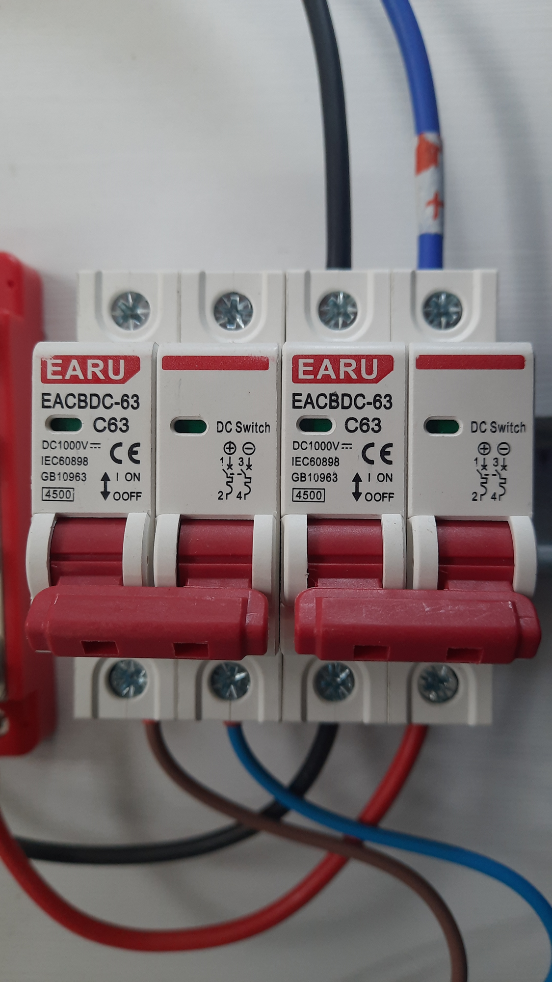

DC MCB Polarity
When i connect battery/PV to upperside
1> Positive
3>Negative is it correct?
2 and 4 s for load?

1 & 2 is the positive end and 3 & 4 the negative, load at the bottom, I believe and thus the solar panels at the top... apparently, since its not bi-directional, it is not suitable for battery connections, since the battery can be a load as well as a source and of course, the inverter end to the battery is the same... can be a load, can be a source...
