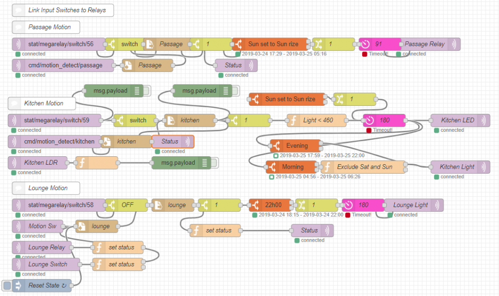

Some of the Node red rules that are running :

Looking at your flows you have some nodes that "set max power" - where do these nodes come from - if they send MQTT messages what actions them?
That is a command that is sent to the Victron Color Controle. Victron "grid tie" works through ESS and there is a lot of options there ( more than what I can handle) but one option is that you can limit the inverter power. So the small script monitors the battery watts and if it falls below -350 w then I set the max inverter power to 15% below the current solar output, I found that that value is about the conversion loss of the panels, the rest of the load will be carried by the grid. At night, no solar, that value will be set to 250 w so my batteries get discharged slowly during the night.
