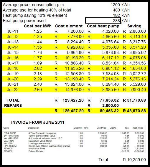

I can just share my own experience which will be for a period of 14 yrs in June with the same heat pump.
Generally the costing aspect is always second hand of what was heard and I have personally never seen a problem about the HIGH cost for maintenance from owners. After observing what was done twice during a service I decided to do the blow out of dust servicing myself. Very few times were there much to blow out but I still ensured the heat exchanger part is not blocked.
Never would anybody not have an aircon due to high service cost which could be more often than the once a year on a heat pump to keep it clean.
My experience including actual cost and savings calculated during 2022 still hold true and since 2022 I had to replace a capacitor at a massive cost of R80 which was 2 months ago. The cost for the feed pump (R2800) included a service. This cost would most probably not have been needed if the installer in 2011 installed a strainer as was the requirement from the manufacturer.
I do agree each guy will have a different ROI as it is driven by the quantity of hot water consumer. Current a 4.5kW heat pump would use about 1.2kW which is much lower than a 2kW element but the heat pump would heat in about 50% of the time the element needs. Thus the saving in PV or battery power could be used to drive other loads. With a more normal consumption of hot water as per my calculation the pay back could be 4 yrs and far from 25 yrs. Not sure with the lower power consumption and shorter time if you took that into account. I have not seen too much detail provided on forums of actual cost. Even if you subtract the annual service cost of say R1200 per year from my savings the ROI would still be I guess less than 6 yrs. But yes it is all based on what costs are used coupled to the quantity of hot water used if this was know. Few of us do have a clear handle on what this would be as well as what time of day and is it free from PV or used after sunset.
My calculation of heat pump vs element in the picture below. I did not include the cost of the 1st service as I don't have the invoice to reflect the actual cost.
A lot of times I don't even switch my heat pump on as the 2nd day the water is still at 40-42 degrees C which is fine for my water temp to shower. Daily use of power on the inverter is available to show actual power used by heat pump as it is the highest single consumption item in my household. In summer my pump never runs more than 1h to get to 56 degrees. To do dishes on the day the heat pump wasn't on I just boil 1 kettle of water to get the fat off dishes and pots and pans.
The great thing about ROI is how one can play around with figures to prove a point.

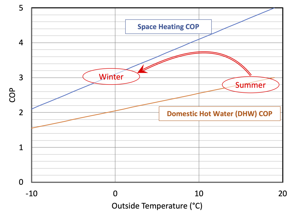

On the point of efficiency I would be interested in what your real world experience is with COP variances between summer and winter. Generally heat pumps are said to be rated at a COP of 3 so for 1 unit (kw) of power you get 3kw of heating so 1 hour to heat a geyser usually but as the temps drop this drops to about 2 or lower depending on the heat pump you get meaning 1 unit will be 2kw of heating (or lower) which is the same as what my element is currently (or worse) so what I will gain is only needing half the power to run the geyser vs what I'm currently using. The only thing I'm looking at is the energy efficiency gains as financially there is no incentive for me to change with my current setup which is making it a harder sell.
