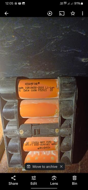

Screenshot_20250407_120517_Photos.jpgTwo of my smaller ingco battery packs have come to end. Im looking to change out the cells, there are 5 of them i see. They are low quality so want to put better quality of ones in.
I could just by a new one but for a bit less i am stuck with same low quality battery.

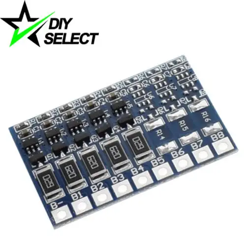

I 100% agree with your statement that the cells are not bad quality, they just dont have a balancing circuit. And all the powertool batteries that I have salvaged from, its always either the bms or 1 cell(or 2 or 3 depends on the construction 3p5s, 2p5s, 3p10s...) that is faulty, if the battery pack have not been abused beyond recognition, and that led me to believe that the absence of a balancing circuit is causing the majority of the failures.
I add a small cheap 4.2v balancer to the packs I rebuild, iirc it only starts balancing at 4.17v at 60ma but it works, so far and it cost about R50
Interesting. Thanks for the wealth of info. Seems a shame these power tool batteries dont come with a balancer. Im a noob with this stuff so be grateful for recommendations. Only 2 cells are around 2.4v. others sre 3.6v. what would you do in this situation?

I will manually charge all 5 cells separately to 4.2v, to balance the pack, and chances are good that the battery pack still have alot of life left in it, I would use it a couple of times and see how many charge cycles it does before the capacity becomes unusable again, if the pack goes horribly out of balance again within +-30 cycles, then will I add a balancer.
If it goes out of balance within the first or second charge/discharge cycle after manually balancing, then im afraid the balancer will be of little benefit if any. new cells is the only way forward then.
I have recovered plenty of cells that had a voltage of 2.4 volts, below 2v I chuck it in the trash, I dont even attempt to revive or capacity test.
I assumed that 2.4v is the standard low voltage cut off for majority of bms'e (actually in this case is just a battery protection board) because I also found a lot of battery packs (powertool and laptop) that the packs was dead, and inside it was one string or cell at 2.4v and the rest at 3.xx volts
