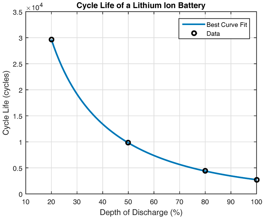

Can you please post some actual hard data regarding your batteries - e.g.:
  • different expected service life (say to 80% remaining capacity) at varying depth of discharge (DOD) or state of charge (SOC), if you like...
  • ditto for operating at various charge/discharge temperatures - perhaps at 10 degrees C, 15 degrees C, 25 degrees C, 35 degrees C and 40 degrees C...
  • ditto for charging and discharging at varying rates of charge or discharge (0.1C, 0.5C, 1.0C, 2.0C, etc.)
  • some expected "real life" scenarios covering (say) 100% DOD daily, at temperatures varying from 5 degrees C in mid winter to 40 degrees C in mid summer.
I'm afraid the small print, such as "This is assuming you were operating the battery in ideal temperature conditions" quoted above, or "charged & discharged at no higher than 0.5C", etc. etc. is missed by many PV owners until after a few years of service at typical temperatures encountered in South Africa or at charging rates in excess of the stated maximum, they are told that their batteries have reached the end of their guaranteed life due to not operating them under these "ideal" conditions 🤔
I'm thinking of something like e.g. the following graph, but expanded to cover the variables mentioned above:
