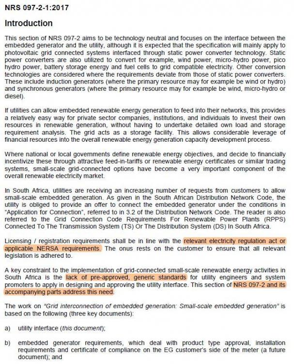

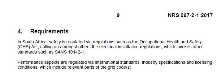

Producing more then 3.5kW: I quote verbatim the email received today at 3:26pm from CoCT: We will unfortunately not move from the NRS 097 guidelines currently.
You have to stick to the NRS limits for your breaker, or upgrade it ... or worse, swap inverters.

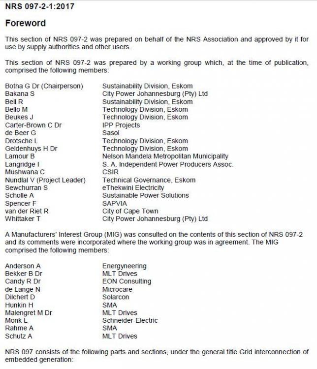

If the inverter is not on "The List" i.e. NRS 097 approved - not a CoCT list no - no chance of it being signed off for gird tied.
Titbit: To get a inverter model, not make, a model NRS 097 certified, costs about +-R100k (+-7000 Euro's) ... that came to light recently.
19 minutes ago, Mistral said:
I have only seen the  CoCT list where is the NRS 097  list?
This penny dropped recently in dealing with CoCT's on the other matter: The list is all the inverters that they are aware of, that have a NRS 097 certification.
See it as a service they have done for us, bringing the list to our attention AND keeping it up to date. 🙂
