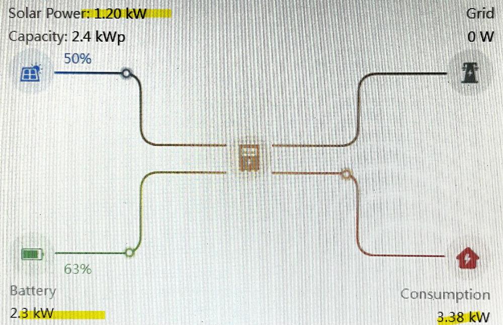

Correct, 4S1P to MPPT 1. I haven't been able to get back to site to do these tests, but here is a screenshot from a few days ago with a 3.38Kw load and the panels giving "full' power at around midday. It was a sunny day. I will return as soon as possible to test each panel. IMG_0057.jpeg
The solar array is producing 50% of its capacity, the battery is 2.3kw towards the load. There is defenitely something wrong on your solar array.

I'm reading a Sofar hybrid manual off the web, and it says that "The HYD 3-6K-EP inverter has two MPPTs, which can operate independently or in parallel. The inverter can automatically identify the MPPT operating mode." And then elsewhere as troubleshooting for a PVConfig Error: "Check the PV input mode (parallel/independent mode) Settings for the inverter. If not, change the PV input mode."
Is there any chance that this MPPT parallel configuration feature/setting is causing the solar power to be capped to 50% of the rated capacity by throtting the current, as if it thinks only one MPPT is connected? Even if that's not it, I'm just thinking that 50% seems so non-random that it suggests there's an inverter setting somewhere that is causing this limit.

You could be onto something here. I did see that setting, but left it on the factory default assuming it would be fine. I will try change the setting to see if there is a difference. I agree that 50% output seems a rather odd clipping, as if a setting is wrong.
