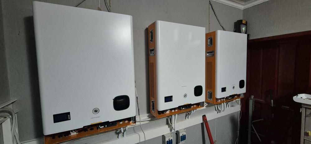

April 20Apr 20 Installing 3 x 8KW's still a lot of work to be done. Will post more pictures when we are done.

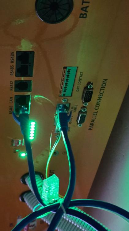

May 31May 31 On 2026/05/05 at 10:27 AM, Jean96 said:Good day All,I'm very glad I have stubbled upon this thread! I bought 2x 8kw Pwr4less batteries in November 2025, and have paired them with a Luxpower SN5000. It is working great, but seem to also have an issue where I can't accurately see my SOC on the batteries connected. I have been playing with the idea of upgrading my 5kw Inverter to the 8KW OmniVolt G2 Hybrid to increase output as well as increase capacity (24kw).From the posts here it does seem that the solution with the Inverter is viable for use, but just want to make sure that everyone is happy with the setup and can accurately also see all the information via the App etc?My SOC was displaying fine even though I didn’t have the comms cable connected. Both inverter and BMS displayed fine. Got the error 64 and had to do what the guys did here to fix it.I connected my comms cable to inverter RS485-2 and the other to the battery RS485/CAN.protocol is PAC and setting 32 is BMS (I have 5kW version so no 485 specific setting shows up). Now all 3 agree with each other on the SOC.I don’t have any solar connected to mine. Just gets charged off my 3.6kW inverter and supplies only the kitchen in the house and the lounge. 3.6 only supplies during the day or when the load on the 2 breakers exceeds my overload relay setting at which point the 5kW takes over.during the night the 3.6 supplies 3 of the house breakers (bedrooms and lights) while the 5kW supplies the other 2 higher power ones (kitchen and lounge).overall happy with it. Only cost me 9k to buy.On 2026/05/05 at 10:27 AM, Jean96 said:Good day All,I'm very glad I have stubbled upon this thread! I bought 2x 8kw Pwr4less batteries in November 2025, and have paired them with a Luxpower SN5000. It is working great, but seem to also have an issue where I can't accurately see my SOC on the batteries connected. I have been playing with the idea of upgrading my 5kw Inverter to the 8KW OmniVolt G2 Hybrid to increase output as well as increase capacity (24kw).From the posts here it does seem that the solution with the Inverter is viable for use, but just want to make sure that everyone is happy with the setup and can accurately also see all the information via the App etc? Edited May 31May 31 by Denns
