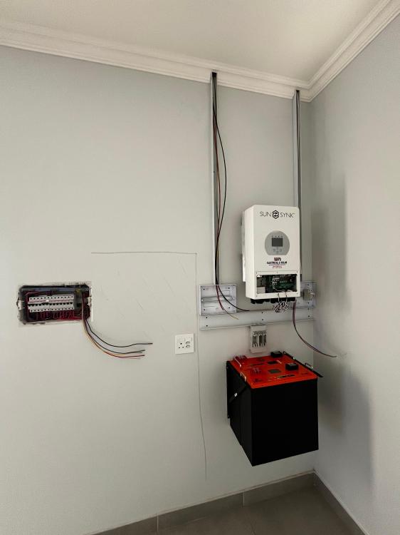

Adding 2 panels to a 6.6kWp E/W split on a 5kW Sunsynk for winter — safe and worth it?
I've been running my system for about 11 months (the inverter and first battery were a lucky gift from my brother-in-law). It's great in summer, but the short days and low winter sun here in the Garden Route mean I'm struggling to cover usage and fully charge my batteries. My self-sufficiency fell from 81% in April to 64% last month, and I'm sitting on 52% at the moment.
I want to add 2 more panels purely to boost my winter generation, but I'm worried about inverter safety.
Current Setup:
  • Inverter: 5kW Sunsynk
  • Batteries: 2x Revov R100
  • Panels: 12x 550W Trina (6.6kWp total) (TSM-550DE18)
  • Split: 6 East / 6 West (24° roof pitch)
If I add one 550W panel to each string (making it 7E / 7W), my total array becomes 7.7kWp. I know the extra capacity will clip in summer, which is fine, I just need the winter bump.
My questions:
  1. Will just 2 extra panels actually make a noticeable difference to my winter battery charging?
  2. Given the East/West split (meaning the inverter never sees peak wattage all at once), is 7.7kWp safe on the 5kW Sunsynk, or is this pushing the hardware too far?
Thanks!

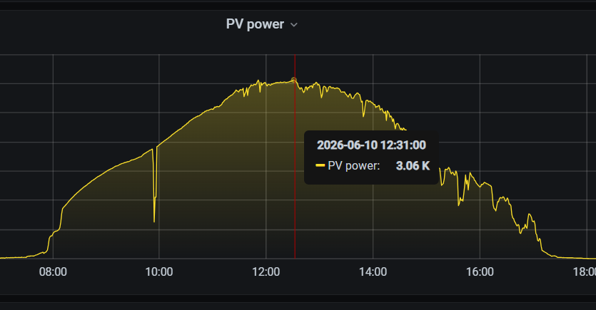

I've scrolled through the Solar Assistant data. In the summer, the amps are definitely getting clipped. But now in winter, it's struggling to reach 10 amps on MPPT 2 and 7 amps on MPPT 1.
This is the highest I've seen the voltage jump when there's little to no load on the inverter.
To give you better context, I'm in Mossel Bay, about 80m above sea level and 1.3km as the crow flies from the ocean. We definitely don't see minus temps, but it can drop into the single digits.
