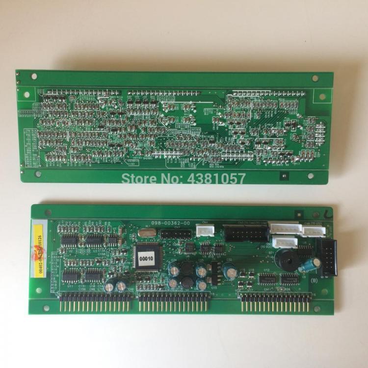

May 20, 20197 yr I HAVE HAD SERIES OF CHALLENGES IN INVERTER REPAIRS, I HAVE PROVIDED SOLUTIONS TO ALL THOSE CHALLENGES EXCEPT WHEN IT INVOLVES A CONTROL BOARD. THE MOST CHALLENGING PART OF IT IS THAT YOU WILL NOT SEE ANY PHYSICALLY DAMAGED COMPONENT IN THE FAULTY CONTROL BOARD. NORMALLY, WHAT I DO WHEN THE INVERTER BOARD CONCERNS THE CONTROL BOARD IS TO REPLACE IT WITH A NEW ONE. IN MY WORKSHOP, I HAVE ABOUT 20 PIECES OF FAULTY CONTROL BOARDS. MY QUESTIONS ARE 1) MUST I KEEP ON REPLACING? 2) IS THE CONTROL BOARD NOT REPAIRABLE? THANKS
May 20, 20197 yr 21 minutes ago, victronics said: 2) IS THE CONTROL BOARD NOT REPAIRABLE? I don't recognise the control board, what inverter is that from? In general the answer is likely NO. Because that chip in the middle with the 00010 on it, that is a microcontroller with some kind of programming that is programmed into it, and unless you are very lucky (and the inverter maker is very sloppy) and you have the tools to read it, you can't replace that chip. Well, you can replace the chip, but you can't reprogram it. Therefore, you almost always have to get a new one from the manufacturer, and they will sell you the whole board and not just the chip.
May 20, 20197 yr @plonkster it's the control board that the Axpert and clone PIP inverters is using. @victronics what sort of problems or errors do the invert show when the control board give problems? Where is your repair place based?

May 20, 20197 yr 3 hours ago, plonkster said: Well, you can replace the chip, but you can't reprogram it. Oh, it can be done, if you have the skillz. 🕵️♂️
May 20, 20197 yr 4 hours ago, victronics said: 2) IS THE CONTROL BOARD NOT REPAIRABLE? One big problem is that no-one seems to have a schematic. Well, I've seen a tiny portion of one, so they must exist, but not for the general public. Apart from getting the bootloader into the processor, there isn't much on the control board that seems particularly tricky, just buffers, op-amps, the power supplies for the processor, and the EEPROM chip. But the back of it is covered in SMD Rs and Cs, so without a schematic, it would be really hard going repairing it.
May 20, 20197 yr What if you move the micro from the old board over to the new one. Test and see if it is the chip or something else on the board maybe?
May 21, 20197 yr 7 hours ago, Luminous said: What if you move the micro from the old board over to the new one. That's a pretty major operation. You need a special heat gun attachment, and it's difficult to solder the chip onto the new board without causing a lot of shorts between adjacent pads.
