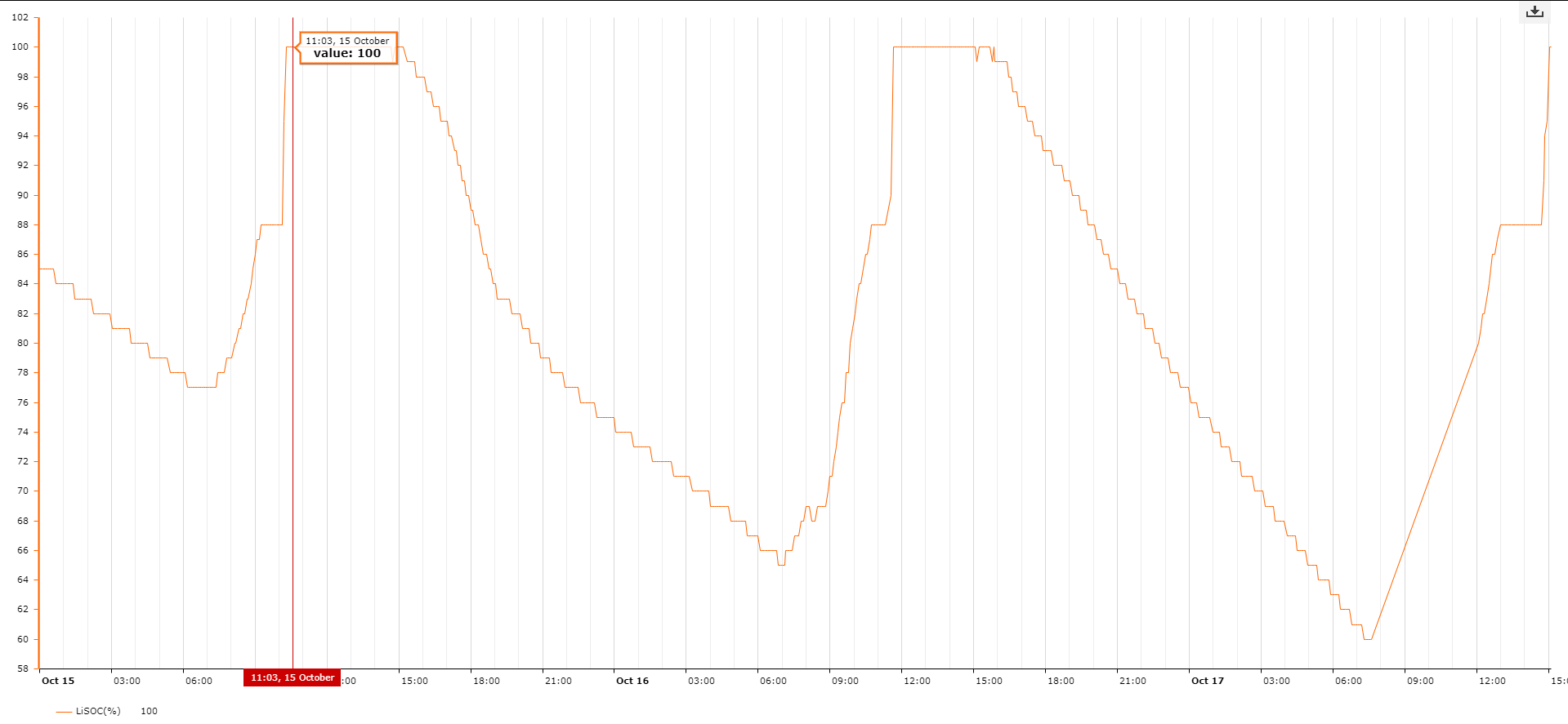

An interesting phenomenon I have seen with all the Pylon installs I have looked at, is that during charging the reported SOC (the value the battery supplies over the CAN bus) seems to level off at about 88% for a while and then suddenly jump to 100%. This is an example of the last few days from one system.
Mine also seems to do it now and then, not every day.
SOC is always a game of estimating. The Pylontech BMS also has a reset at the top, just like the BMV. Unlike a lead acid, if the voltage rise above 3.45V per cell... you know the tank is full. None of this "absorb for a few hours more" nonsense 🙂
