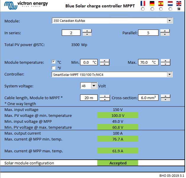

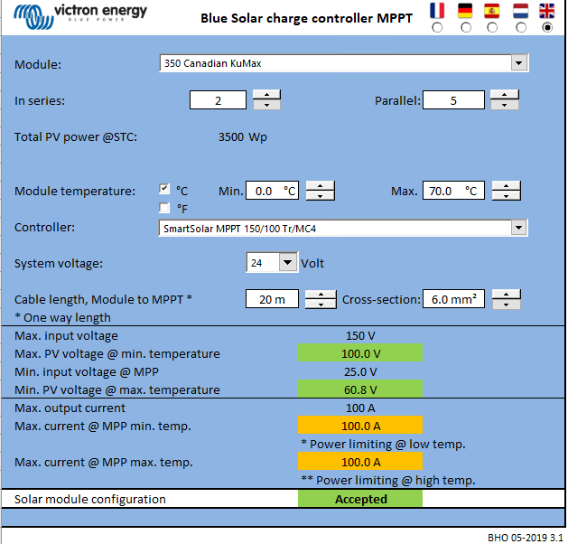

July 17, 20197 yr 2 hours ago, Jaco de Jongh said: I have to ask about this, only if it is to learn something new, ... The two core non-negotiable undeniable rules for all controllers are: NEVER ever exceed the Max volts of the controller. NEVER ever exceed the Max PV short circuit current of the controller. Using Victron's Calculator, one can do this: 1 and 2 is ok for that is under peak conditions, full power drawn from array, and in Cape Town winter I don't see that ever a problem. Rest of the time it would be interesting to see it drawing the full potential of the array to make it clip the Max current.

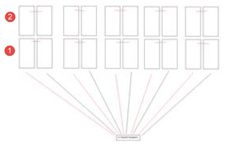

July 17, 20197 yr If it all comes to play, it is done so for the newbies - but I must say, I also need to go 48v inverter! 1) First array - 3.5kw = 10 x 350w set as 2 in series / 5 parallel with 6mm2 wire and 5 x double pole 16amp NoArk breakers - no fuses required. 2) Upgrade - IF needed - add another 10 x 350w = 20 panels in total - and no change to combiner box, just upgrade the 150/100 to a 250/100 MPPT. IF I cannot find 350w or 355w panels at that time, then simply another 150/100 and 10 panels, and stay on 24v.

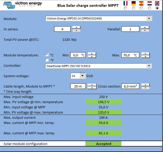

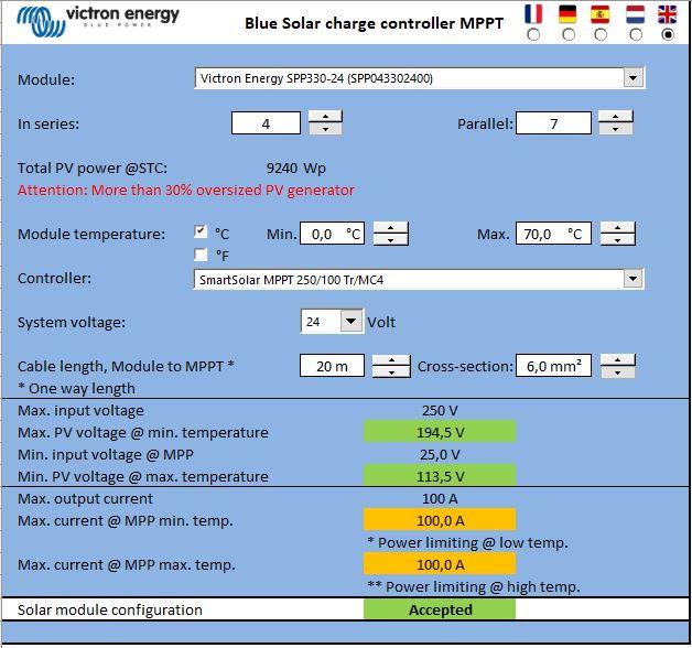

July 17, 20197 yr 58 minutes ago, The Terrible Triplett said: Rest of the time it would be interesting to see it drawing the full potential of the array to make it clip the Max current. Please be careful not to fall in this trap while designing your system. The following pictures will show you why. The aim is to have everything green. Yellow means that the output is been limited and adding more strings will hold absolutely no benefit for you. Although you add more to the input, the Mppt wont allow out more than its output rating, in this case its 100 Amps. (No benefit except for early morning, late afternoon and cloudy days, but in the middle of a perfect sunny day, your array will be in idling mode) At the bottom of the data sheet, point 1A, you will see the logic's behind it. Now look at an example using panel supplied by the app itself. Start with one string of 4. All green (Total PV = 1320 Watt) (Total PV = 2640 watt) Add 1 string. Cold whether output gets clipped, note we are getting closer to Nominal PV power on a 24Volt system as per Datasheet 2 posts up (2900). (Total PV = 3960 watt )Adding one string more. Now Cold and hot weather output gets clipped. Everything you add after this point will not contribute to the output under normal sunny conditions and will only come into play during low light or cloudy conditions. (Total PV = 9240 watt ) I can add another 4 strings, without adding 1 amp to the output and still have an "Accepted" Green at the bottom. (Total PV = 10560) Only when I add string number 8, the app tells me "NOT accepted" Although the app allowed me to add 4 more strings I had absolutely no benefit on the output side, that is why it is best to design your system toe the Nominal PV Power for your system voltage on the Data sheet, and if you have some extra money, add 30% to that, to help in low light conditions. Anything more than that will be a total waste of money for most parts of the year.

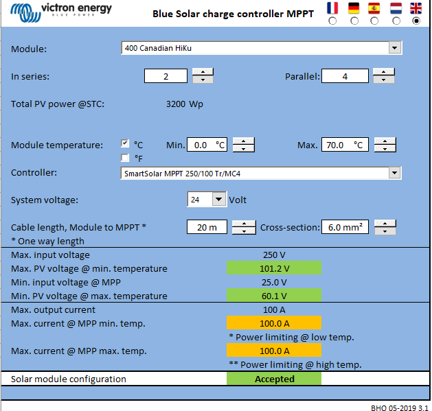

July 17, 20197 yr 47 minutes ago, Jaco de Jongh said: Yellow means that the output is been limited and adding more strings will hold absolutely no benefit for you. Correct. Ps. Interestingly on a 24v the 150/100 reaches "More than 30% ... " "differently" than the 250/100, see pic below. 400w panels gave their own challenges. Ok, first point: Inverter can use a max 2.4kw max continuous, anything more ito paneling and one better have more batteries. Note 1: I run the old bank "Keep fully charged" ... for now.Note 2: I can swap the inverter at a drop of a hat with a 48v unit, re-registration but a minor inconvenience. It all started because in watching the data the last few months, I saw that the 2.1 kw array easily runs out of steam being kinda "pure" grid tied, more so now that I have another geyser (2kw elements) on the system. And being winter it gets even more interesting. I need the 2.4kw from about 11ish to 5pm-ish. That is for a +-500w average load and 3 x 2kw heating elements - all on timers. So I sat down and "played" around asking: What combination can I put up one time that: 1) leaves room to maneuver, 2) AND can provide the 2.4kw I want for longer, 3) AND can double up IF I want to really push the envelope next level? Answer: 3.5kw array. Theoretically I should get 2.4kw easier from a 3.5 kw array as the MPPT cannot draw more from the panels than what the inverter can use. So the Yellow is a non-issue. But I can get to 2.4kw earlier and also for longer in the day = better average of getting that max of 2.4kw spread over the entire day. And WHEN I add more batteries then I suspect I could be pushing the Yellow limits right? So, I simply sell the 24v unit and get a 48v unit. See 2nd pic below. So, with the goal of getting 2.4kw from the array as consistently and for as long as possible in a day, I recon I got it covered on all sides and bases ... or am I still missing something? And remember, I have a "escape" route planned IF I need to push the 3.5kw array to it's max with more batts. If I go 48v one day, same 3.5kw. Not boxed in in other words - and I can THEN add more panels and start the dance again.

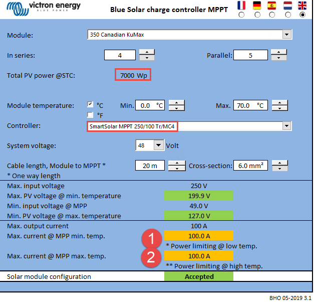

July 17, 20197 yr 2 hours ago, Jaco de Jongh said: Now that I can agree with...... ... then you are halfway there. 🙂 Because on a 48v system the exact same logic I used for justifying a 3.5kw array on a 24v system, will apply "as is" to doubling the array to a 7kw array on a 48v system. The ONLY caveats being: 1) YOU HAVE THE BATTERIES to store that power. 2) AND / OR you have 2 x 3kva (2.4kw continuous) inverters in parallel = 4.8kw AND THAT YOU CAN USE THAT 4.8kw near continuous. For me to get to that level, yes the plan is in place, Eskom would have failed us horrendously and therefor ... well, lets just say a whole new set of rules shall be followed. Let me share how I got to it: What I did was I loaded a few panels and over a while I mixed and matched the combinations until I felt I had the most watts from the array WITHOUT getting the "Exceeding 30%" warning. That is also where I saw that the 400w panels do not "fit" so nicely. The i.e. SPP330 panels you used to illustrate your point does not "fit" nicely. They and the 330w Canadians get to 6.6kw before the warning of exceeding 30%, which is at 8.25kw. On a 48v system with a 250/100 MPPT - the "rule" used is to not get a "Exceeding 30%" warning right? So a 400w panel gives you up to 6.4kw before exceeding 30% at 8kw. I can get to 7kw with the 350w panels. FYI. Why I like larger panels: To get to 6.5kw with 400w panels you need 16. I like. To get to 7kw on the 350's, you need 20 - I suck it up and take the 500w extra. 😉 And on 24v system, 400w panels gets me to 3.2kw before exceeding 30% at 4kw. I can get to 3.5kw with the 350w panels. The 330w panels gets me to 3.3kw ... Edited July 17, 20197 yr by Guest
July 18, 20197 yr 12 hours ago, The Terrible Triplett said: ... then you are halfway there. 🙂 Your current "logic" is just telling me what I have already told you above. None of what you are saying explains how you got to your first "logic", (7kw on 24 Volt) On 2019/07/17 at 12:14 AM, The Terrible Triplett said: I can add another 10 panels and go 7kw on a 24v system. But lets leave it there... just glad we could straighten it out before someone follows your "logic" and install 7kw on 24 volt, resulting in almost 2/3 of his array just sitting on the roof not adding value to his setup under normal conditions.

July 29, 20197 yr On 2019/07/26 at 6:18 PM, StephenB said: Its trivial but it's a big thing when you dont have power when u awake. Nothing is trivial when you don't have power. 400w panels on a 150/35 is interesting. I see you can get to about 1600w (2S/2P) on 48v and only 2S (800w) on 24v. 24v gets one quick to the limits of a MPPT and forces creativity ito matching what panels to which MPPT's.
