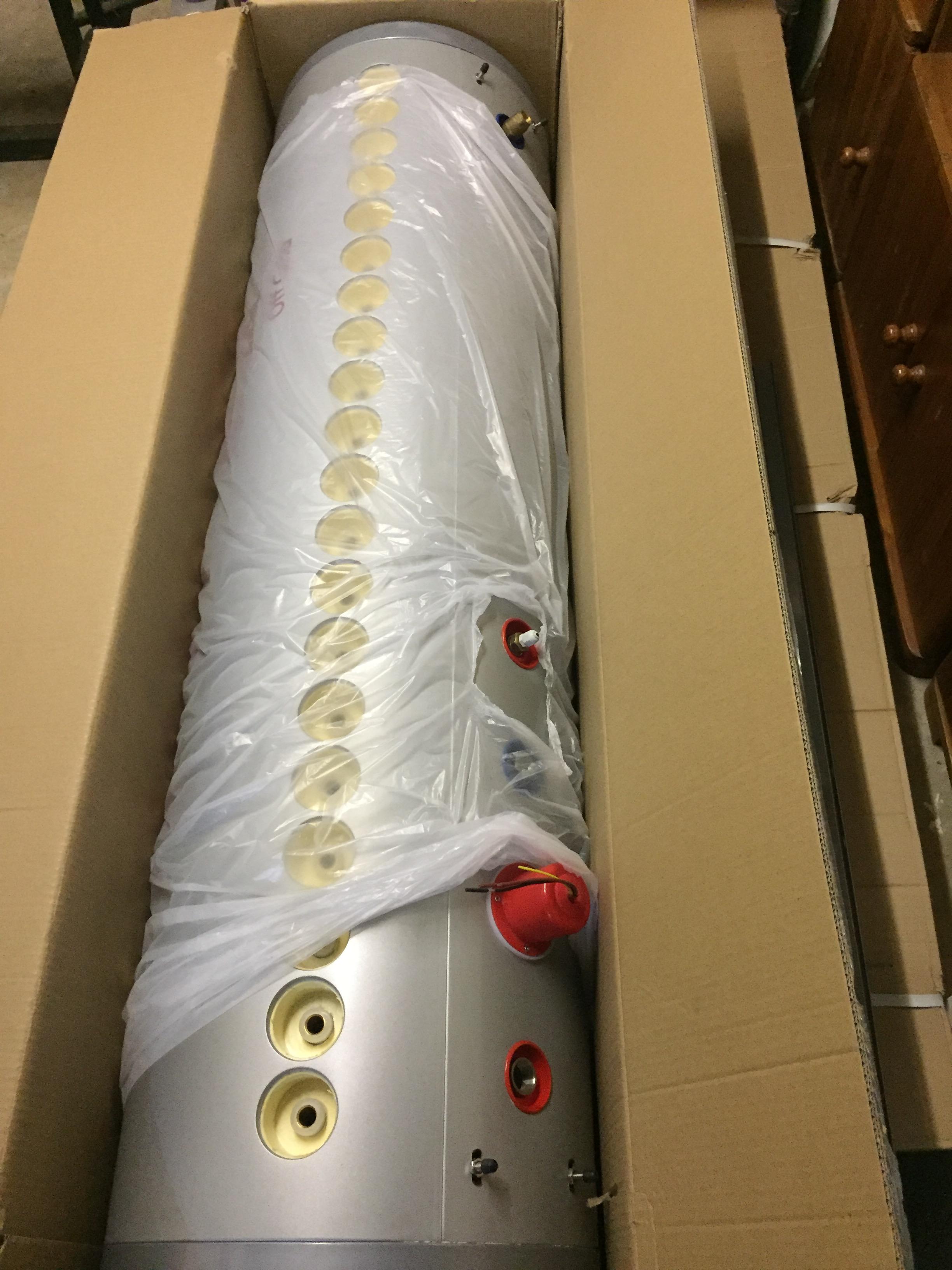

I am no expert on solar geysers but I did install and assemble my geyser myself, and there were a few things I noticed on the ev tubes while installing them.
1. There is a possibility of the copper rods inside the glass ev tubes sliding down, due to gravity/vibration. Especially with time and not making good “contact” with the manifold heating area. - These can be pushed back up when removing and re-inserting to eliminate this issue.
2. Also there is a heatsink paste that improved the “contact” of the copper rods in the manifold and it might be worth while to check if it still exists especially after 9 years. - check it out while removing.
These were logical observations of what can go wrong while I done my installation😎
3. A small issue I experienced was the temperature sensor was not making good contact in the port where it sits and it was only reading 55 Deg on the display and by moving the sensor around and pushing it up, the reading shot up to about 80 Deg. This temperature sensor wire is very thin and the gland do not lock the cable tight so it could slide out and give false readings.
You might of already checked this, but if not its worth looking at before thinking of geyser replacement.🙂

Yes, this is a high pressure geyser. The rods on this one can only push in about 50mm so if it is not pushed in deep enough you will loose efficiency.
