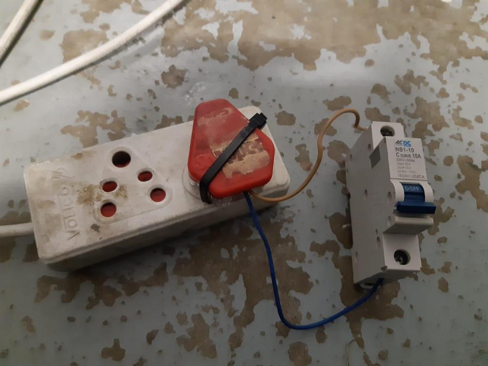

I found at least one good use for an AC/DC breaker. Inverter overload tester...
66795093_10157174279850619_1329514230352707584_o.thumb.jpg.8f2bdea892cd0ede048a944073e1f4d1.jpg
(The dead short current on a 3KVA inverter is only around 30A... even a 10A is enough to take that... and I don't mind burning the contacts to hell...).
