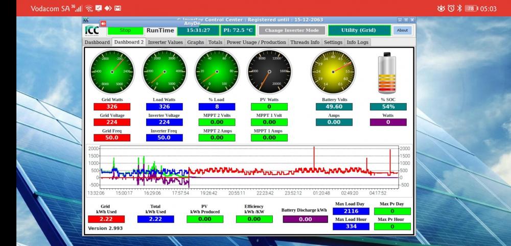

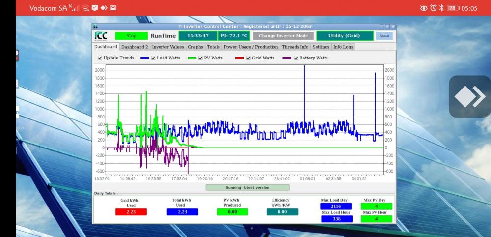

@GVC Did not do what I expected........
Seems during the daytime, it worked until the PV output dropped.  The load was then powered for the whole night by the grid.....did not go to battery as i expected.
I have changed the Axpert setting [01] back to SBU this morning and left the setting [16] on OSO and will monitor today...
This screenshot is from the time I made the changes to around 05H00 this morning.
Edited by SagieN
Yes, If you set 01 on SOL, then as soon as the panels stop producing it changes back to grid. SBU is much better as it will run on the batteries once the panels stop producing. I would recommend that you set your SOC to control the batteries as well....say "back to grid" at 30%.

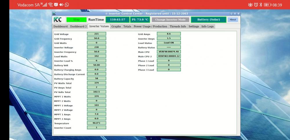

Thanx for that....  Don't have a BMV yet.....  Trying to source a cable for the dyness as there seems to be no one who knows how to get it to talk to the Axpert. I have spoken to Riaan from ICC and he says he needs the Dyness comms protocol to check if the Pylon cable would work...... No idea where to get that from.
Will post the screenshot of the performance tomorrow morning....
