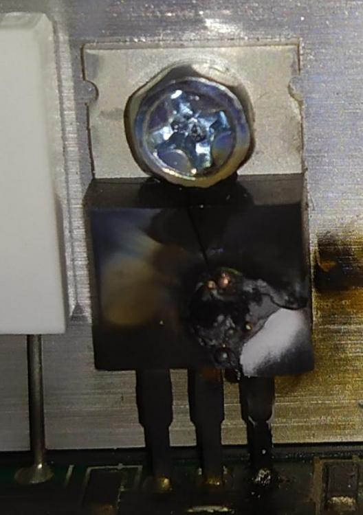

I currently have a 6 year old 2kva Axpert on my bench and alas it appears one of the Mosfet's on the DC-DC converter took something of a dump. The mosfet is blown wide open and there's splatter on the board and plenty of smoke staining in the surrounding area and generally all over inside the enclosure. Unfortunately I don't have schematics for the board so before I tidy it up fit a replacement component I wondered if anyone has past experiences of Axpert repairs.
They can do that. You need to carefully get rid of all the carbon black stuff as it is conductive. If any PCB traces are blown, that makes it very difficult.

What is the usual failure mode when this particular inverter blows a mosfet?
With the 5 kVA models, at least one upper and at least one lower MOSFET turns on at once. But this is push-pull, so that may not apply.
Quote
Is there likely to be collateral damage
Yes. Very often, the whole transistor will fail shorted (hence all the splatting), so battery voltage ends up on the gate drivers, frying them. However, with a 24 V model, the gate drive is often 15 V anyway, so 24 V from the battery may not be such a drama as on 48 V models. So check all gate resistors (the series resistors as well as the pull-downs), and any discrete transistors that are used as gate drivers.
