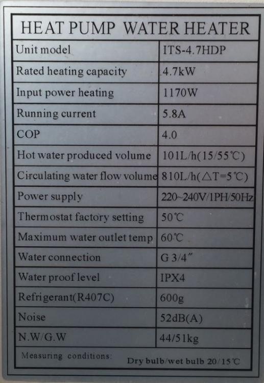

Guest Posted April 30, 2016 Share Posted April 30, 2016 Let me rephrase my take on this. I am not saying anybody has to do what I did or should have done. But for our situation the heat pump works better. Let me tell you why. My wife takes a bath 2 times a day, sometime 3 times depending if she went to the gym. She likes being clean, don't ask , And I will also take 2, one in the evenings (I have to be clean if I want to get in bed ) and one in the morning after gym before I go to work. The 2 kinds each take a bath in the afternoons around 6pm. So we run out of hot water in the mornings as there is no sun to heat the water during the night (and when I say run out it is still fine for me but not my better half, +- 40 degrees). So if I want to stay married then I need to make sure there is hot water for the wife in the morning. Thus my ultimate solar power and solar water solution will be as it is now. Grid tied inverter that feeds back to the grid the extra power, then we can run the heat pump any-time of day. I don't have any elements inside the tanks, the tubes will heat the water to a point during the day and the heat pump will the top it up or heat it all together. But if I had to do it again, I would just use the heat pump as it did the job for 3 years already. PS when I say ugly my wife told me I am not allowed to install a "Hoender Hok" on the roof LOL. It still needs to look good, so that is why I went for the retrofit system. Quote Link to comment Share on other sites More sharing options...

Guest Posted May 1, 2016 Share Posted May 1, 2016 Today is the perfect day to show what I mean by our situation. Again this is only my view based on our situation Quote Link to comment Share on other sites More sharing options...

Guest Posted May 3, 2016 Share Posted May 3, 2016 If you are installing retrofit and want to add a tank I was told to stay away from Kwikot tanks as they tend to burst in 2 years time. I can not comment on any other brand than ITS as that is what I have. The system look a lot like what Carl showed here on the forum. Same controller and tubes. Quote Link to comment Share on other sites More sharing options...
