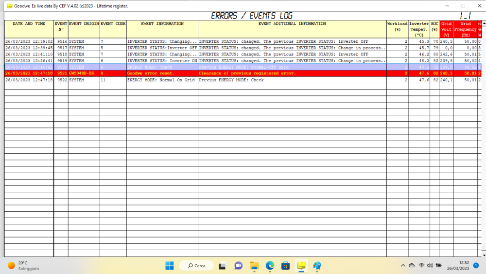

On 26/3/2023 at 12:54, abrax said:
Oggi è la prima vera giornata di sole, ho notato che l'inverter si è riavviato più volte. matte la schermata di errore
prima che fosse scritto DC current high
I opened a ticket to goodwe, today they fixed me, they set the inverter remotely, I haven't had any problems since today. thank you all for the support. I have to say they were quick to respond .

@abrax With all due respect, I think some concepts are mixed.
The screen you show in the post does not indicate any Goodwe error. The code "0" appears in PV Master (I show it in my software taken from the Inverter log) when an error condition disappears, that is, when what was an Alarm condition for the inverter firmware is no longer present.
For example, the Alarm: Nº: 512 (Utility lost) when there is a power outage of the grid generates a condition that persists until the electrical service returns to your home, where the code "0" appears.
You understand ??
In the Error Log I identify different types of Goodwe's own Alarms, status changes of internal variables of a logical type, and situations that, due to changes in the operating parameters, I estimate may be of interest to Advanced Users, as well as certain actions of the user.
The Goodwe alarms/events that you can check in PV master in this software appear in yellow letters with a red background.
If you have what you think is a problem on your Goodwe, it would be nice if you would make a separate post of this thread, so that many Goodwe users who do not use this software can give you feedback and/or benefit from solving the problem you are having or do you think you have
It would be important that when you create the Post you make screen copies of the error that the PV Master shows you in the android application in its own error log.
In this forum you will find many people willing to help you but in general they will answer you if you are clear in the presentation of the problem.
Regards !

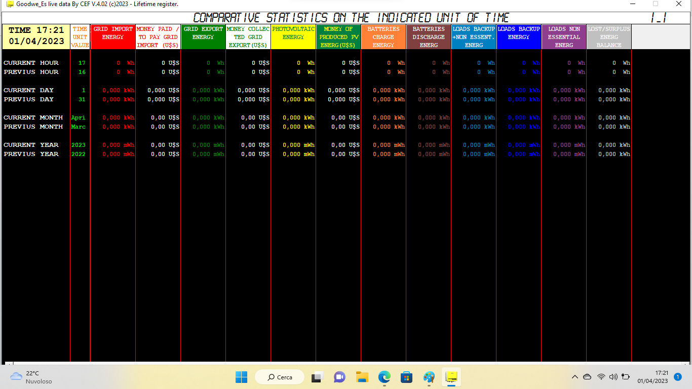

Il 2023/03/28 alle 12:29 PM, BGb ha detto:
utilizzare la scheda CS -grid import energy
Sono sempre stato zero, penso di dover configurare i parametri. Potresti aiutarmi?
