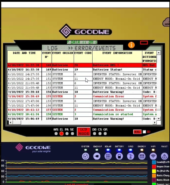

I'm sorry to inform you that the current version (3.40) won't tell you anything about cuts in UDP data transmission over WIFI network.
To version 4.0, which I estimate I will be able to upload to the forum in about 10 days, if I incorporate in the control and historical record of Events and Historical Record of Errors, a "Freezing" Event of the information transmitted by the Inverter to its LAN network and its restoration.
You, in this version, will be able to check when the Inverter stopped communicating with your Router and when it started communicating again.

Error messages
I'm getting a battery over voltage alarm, BMS code 8.  The batteries do not show an alarm. I have 2 PylontechUS3000 and one US3000c.  I think I read somewhere that I must change a setting in parameters but cant find it now. If you can help it would be great.
