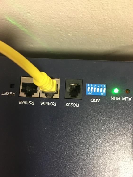

Justice MM Posted June 23, 2021 Share Posted June 23, 2021 Hi. I have just installed a Shoto 5.18MWh and Deye 5-kW inverter and since March I have been struggling to get it working problem. The setup is used as loadshedding buster. During the Grid events, it works fine for a few hours and then trip after a few hours. The fault is "F40 Batt_Over_Current". I have since noticed that the inverter is not communicating with the battery and have tried a number of permutations to get it working. Kindly advise where I am making a mistake. Quote Link to comment Share on other sites More sharing options...

Justice MM Posted June 26, 2021 Author Share Posted June 26, 2021 The Shoto battery is made by Shuangdeng. I contacted the supplier and they sent me the communication setup which says I must use CAN and set it on 00. I have attached the document. Deye Inverter communication set up.pdf Scubadude 1 Quote Link to comment Share on other sites More sharing options...
Justice MM Posted June 26, 2021 Author Share Posted June 26, 2021 I tried to use these settings but same thing happened. The temperature probe doenst work either. It reads -100 Quote Link to comment Share on other sites More sharing options...
YellowTapemeasure Posted June 26, 2021 Share Posted June 26, 2021 That document is straight out of the Deye manual (Appendix I). As per the Deye manual page 31, this is the screen where you set it: If comms is good then you should see something like this in your LiBMS screen: If you don't, then it could be a cable fault, try swapping out the cable. If this does not work then I suggest returning the battery to the dealer. Alternatively you can try to use voltage to determine SoC, but you will need these very specific voltage settings from the manufacturer. It's also not the greatest way to do things, and will probably affect your battery life. Quote Link to comment Share on other sites More sharing options...
