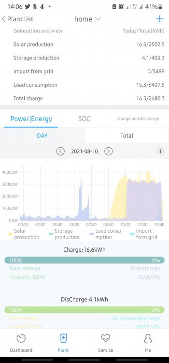

So I was expecting that I would see around 80% of the installed 6kw of panels which would be enough to power the load and charge the batteries. But the inverter reduces the pv power to match the load which doesn't make sense to me since the reason I got it was the 6000 watt pv input which allows a 5kw load and 1kw for charging batteries.
Here is a screen shot let me know what you think.
Here is a screen shot from today. I feel like I'm losing a good 2-3kwh from this inverter behavior and it is motivating me to jump ship and join the Sunsynk bandwagon.
Thanks for having a look @Achmat, here is a screen shot of my SOC for today. It's typical for most days. I've managed to get it as low as 20 % before the sun comes up without triggering a utility  charge. I have the timer set to turn on the geyser at 10h30 which usually has my dyness powerbox f10 at around 70%.

So it looks like its due to the batteries being charged (Looking at your last post)
The inverter will only draw as much power from the PV as the demand requires. No more. So, if you had a constant 700w load all day on the inverter and batteries were 100% SoC; PV will be clipped to this. Where else must all that extra energy go? 😛
You'll note that your battery reached 100% SoC at around 12:00 - roughly the same time your PV dropped off or started "clipping" - this is normal.
