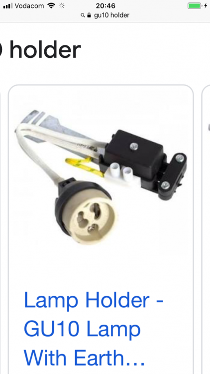

Secondly can I do it myself? Seems I can DIY it quite easily, am i overextending myself and capabilities? I would imagine i just need a few of these Lamp Holder - GU10 Lamp With Earth Term – Brite Lighting and i should be good to go.
Currently the connectors are not earthed, so i do need to sort that out when I connect them , I think.... Do they need to be earthed, or can i use Lamp Holders without an earth terminal?
Earthing is always the better option, some will say if they are out of arms reach they need not be earthed, but when you need a COC you might find the earthing is non-compliant, the bright light fitting looks correct and should pass a COC if installed correct.
Only you can answer that question, but I would say a multimeter is a basic must.  Make sure you connect live where live must go (hence multimeter), neutral where neutral must go and since you are moving over to 220v your lights need a grounding wire that should be connected to metal casings (most downlight casings are metal).  If it is plastic then the ground wire just hangs out in the roof.  Earthing is a requirement in the regulations, without it, if the live wire should touch the casing it'll kill someone who tries to change the bulb.  This happens pretty often believe it or not because those lights have wires that are constantly pulled on.
Thanks, i just did the first room conversion today, went great. Everything earthed. New lights  are great and my room is now so quiet without the transformer buzz.

  1. What is the best way to bond the metal light fittings to the earth terminal of the GU10 Connector.

1. Usually metal fittings will have a screw where you put the earth terminal, if you take a picture of both sides I'll point it out.

The easiest and SANS compliant holder to use in a ceiling void is the type with the ready earth terminal and the metal plate that hooks on to the down light at one of the butterfly springs. Down lights is a big headache when it comes to issuing a COC because the electrical terminals need to be enclosed in a junction box. If you have the cheaply two wire holder without a earth you will most probably not get it COC’d without some sort of additional junction box and earthing intervention that can become very expensive.
