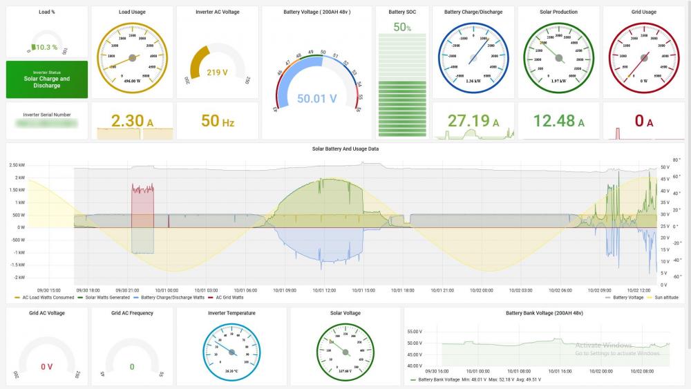

October 2, 20214 yr Finally took the plunge and bought a better Off Grid Solar System Was again a bit of a learning curve to extract the data from the inverter. Finally have it working on RPi4 using a bit of Python with MQTT, Influxdb and Grafana Always amazes me how data can become so easily visualised on a single page.
October 2, 20214 yr Care to share how you accomplished that? Perhaps have a Pi image? well done.looks really good Edited October 2, 20214 yr by JoeyhZA
October 2, 20214 yr Author 3 hours ago, JoeyhZA said: Care to share how you accomplished that? Perhaps have a Pi image? well done.looks really good I will see what I can do to share this. Currently it only works for the growatt spf5000es, I am planning on making it work for other growatt models and maybe other inverter Brands too.

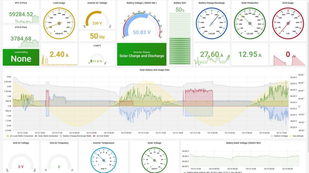

October 15, 20214 yr Author Since crypto mining is paying for all the fancy new equipment I guess it should be fitting to add the crypto prices to that stats display

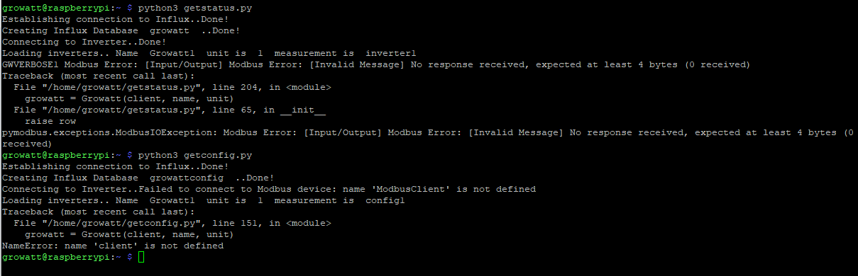

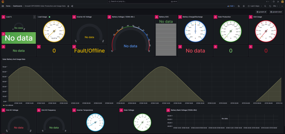

June 22, 20233 yr hi all, i installed grafana on my raspberry following this guide: (https://github.com/sdsolomo/growatt-x000ES) I can access the webpage by typing raspberry IP:3000 but I don't see any data. From ssh if you do this command: growatt@raspberrypi:~ $ python3 getconfig.py python3: can't open file '/home/growatt/getconfig.py': [Errno 2] No such file or directory I get the error, how can I fix it? Edited June 23, 20233 yr by capoccio1
July 10, 20233 yr hi, can someone help me? I followed the instructions step by step but I can't read the data
July 11, 20233 yr Author Hi @capoccio1 Did you download the pc software as I suggested so that you can test if you actually have communication with your cable?

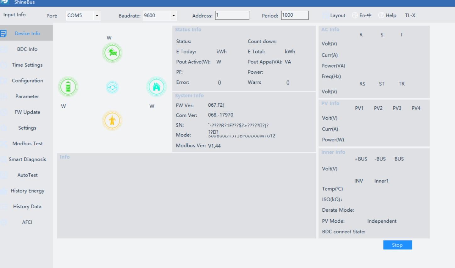

July 13, 20233 yr Hello, I contacted the inverter supplier who sent me the program, in the photo you can verify that the inverter communicates with the PC showing all the data, the USB cable works well.
