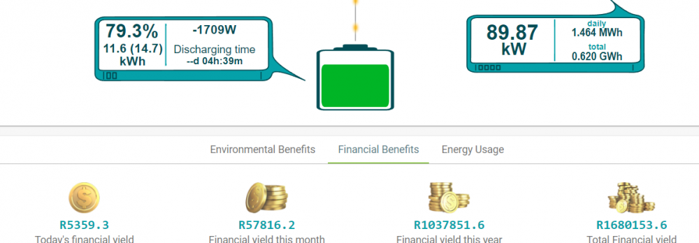

October 11, 20214 yr <Okay just a rant> I've been happy with their batteries so far. But their logger and software update process however is a full on disaster. One basically can't rely on SolarMD for meaningful stats and logs. Also I don't think they test before doing software updates - i've last summer's data/logs (three months worth) basically disappear when they did an update. Also no warning or notice to customers before said software updates. Currently now the dashboard is showing wonky data, ie +-90 kilowatts continuous draw (wtf?).... and I apparently consumed 5.3k worth of electricity today.. hahaha. guess their devs been playing on the live environment again 🙄. Luckily I have SolarAssistant plugged in to the second inverter and am able to see system's status. Oh yeah - had to purchase SolarAssistant as SolarMD doesn"t have API I can use for HomeAssistant/NodeRed. Sorry for the rant. I'll relax now.

December 6, 20214 yr Author On 2021/11/11 at 11:06 AM, henry-t said: Hello @MockTurtle, Regarding the lost data, the Afrihost server crashed. Even with the storage configured in RAID the data was not recoverable. From there, a lot of server reconstruction has taken place, including the DB now running in a cluster on three separate servers, all synchronized. This makes it really robust and also increases performance. With all the changes in server infrastructure there were some growing pains along the way, and most likely there will be some going forward. But client feedback is really helpful and will help with fixing bugs that aren't caught before release. You can recover the lost data since it's stored on the logger too. If you contact support they will help you out. Extending on @platar86 comment on MQTT client, you can enable it when you navigate to the logger device and it's there in System Settings. There are people using it with Home Assistant from what I understand. Regards, Henry Really glad there is now an mqtt interface! I have configured it and it seems to work... albeit its only one way at the moment - see suggestion below. ...however I wouldn't have known of these developments (and what the story behind the 'lost' data was) had I not logged on these forums... one should not have to rant on a public forum to get meaningful feedback 😐 ...also i have noticed lately there are broken image/logo links - so i know something has changed. some suggestions: - maybe add a notice functionality on the mypower24 dashboard. you can notify users of system changes/updates/issues/new features. heck you can even plug sales pitch on there... - ability to send mqtt commands as well? ie to toggle loadshedding prep mode, set discharge levels etc. that would be really be icing on the cake. In any case, once again I really appreciate the response and the new features ...am really hoping things improve.
