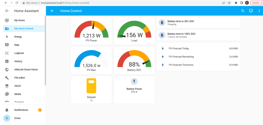

Hi Everyone,
thanks for this post, I was able to use the code to do both time to 30% and time to 100% SOC, now I'm interested in modifying it to use an average consumption rather than the instant current power.
