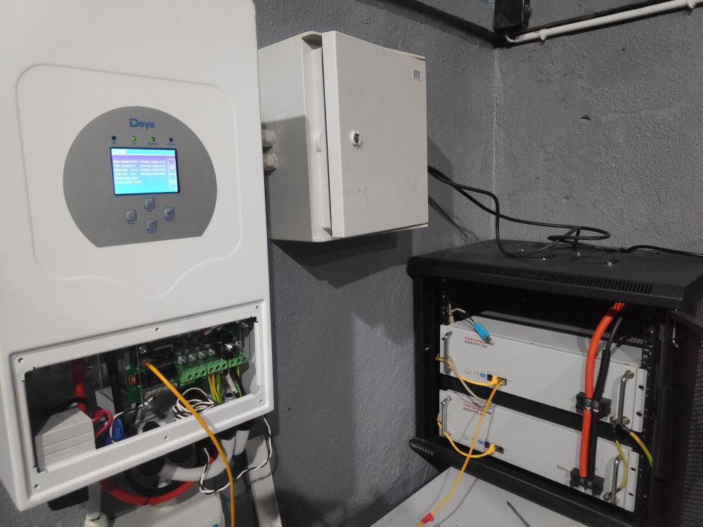

I have just finished setting up my SunSynk 5k Hybrid and manage to get it to talk to my Narada 48npfc100 but with different pin configs to above. Perhaps it is a Sunsynk vs Deye thing or it could be the cause of my 1 remaining issue. My Inverter is seeing only one of my two batteries
From my side the wiring is as follows
Inverter side is Pin 1 & 2 which goes to Pin 6 & 7 on the battery side respectively... This is the only combination I can get that works. Pin 7 & 8 also work perfectly when using an RS485 to USB adapter when connecting to ICC / ICM or Solar assist.
My batteries dip switch are 000000 (Master / Pack 1) and 100000 (Slave / Pack 2). I know the batteries are talking to each other as when I look at them in ICM, I can see full details for both batteries. I have tried plugging the inverted into any and all of the RS485 ports on the two batteries and it still only reads which ever battery it is plugged into.
My Inverter is running COMM:e420 - MCU:3370... I know there is newer firmware but not sure if this is this issue. Either way, I am going to request an upgrade tomorrow.
Anyone else have it running on a Sunsynk? With multiple batteries? Can you see all the batteries?
Thanks in advance

Sooo... You are brilliant!!!! I was following the dip switch settings as per my manual but yours work and now I can see both batteries without an issue. Going to be very interesting to see if they balance themselves better with this setup (not that I had much of an issue before)
7 hours ago, zivva said:
Ok, weird 🤔 100% sure of your cable ?
You can use the left or right RS485 port on the batteries, doesn't matter. I tried both ;)
100% sure... I made enough of them and tested enough times with my RS485 to USB to read the batteries first.
 Inverter Side
Battery Side
To say that I am overly chuffed with myself is an understatement.... I was soo worried, I was going to have to continue to rely on a 3rd party software to link the Inverter and Batteries again was annoying me but happy days!!! Hopefully this can help others going forward too!!!

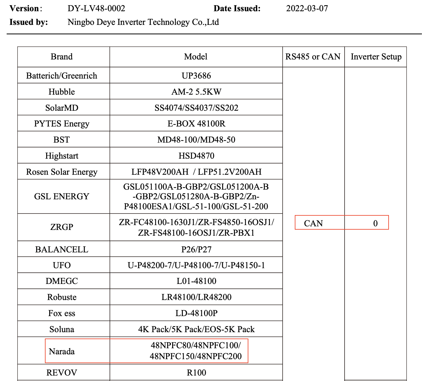

I've been in contact with Deye and have received new information. The connection to Narada uses the CAN port now apparently with the latest firmware on the inverter, please see attached.
I have been unable to get the info on which Narada pins should be connected to the inverter CAN H/L pins despite asking several times.
最新-Deye Approved Battery list(DY-LV48-0002)(1)..pdf
Might be just a typo :
- the former list of approved batteries, published the same day with the same revision number, says RS485 / protocol 16 for Narada ;
- Narada mentions only RS485 protocol in their various documents
