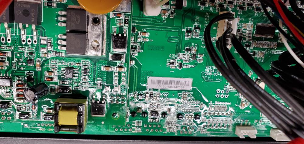

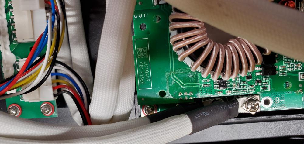

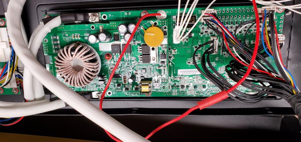

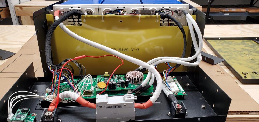

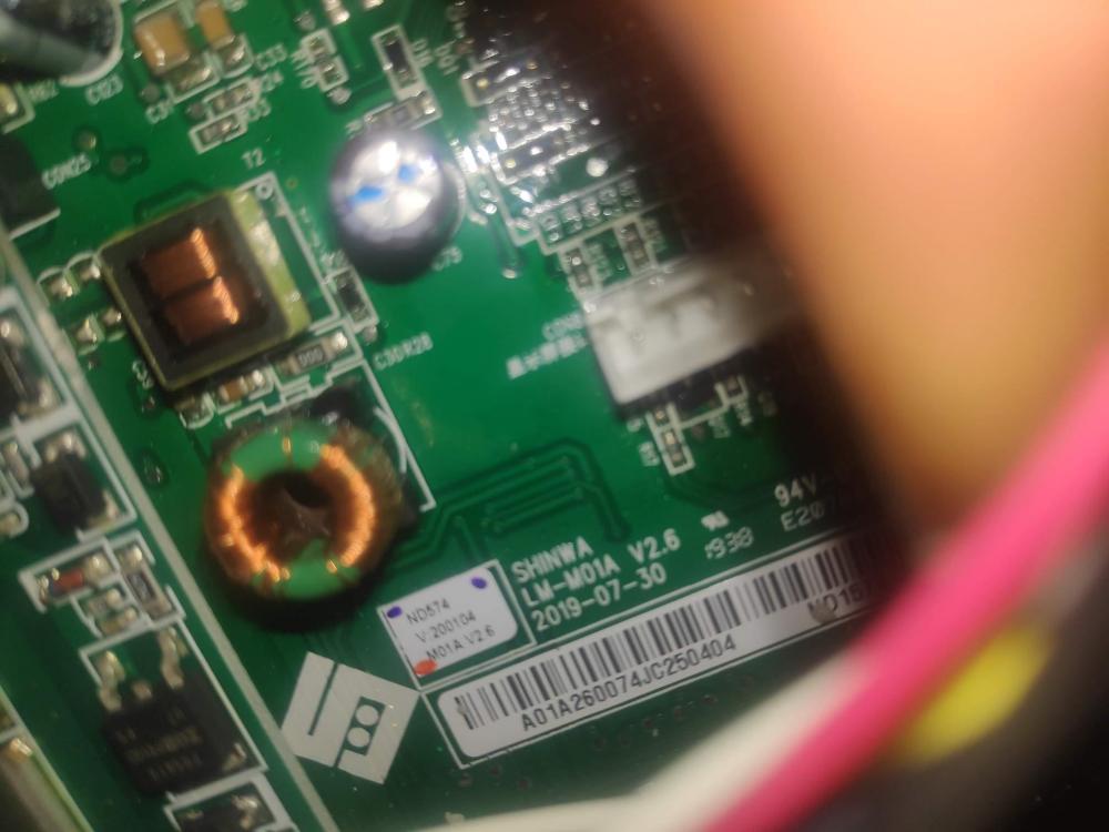

hi
can any one confirm this is shinwa bms board
any one having tian bms can u share the internal hardware
here is my bms similar model inside

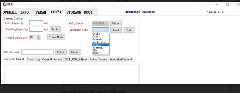

does any one have any /or have any contact with shinwa bms pc software tool/company,
if any one having narada bms tool kindly reply, for  rs232 com port
for firmware change or to add or change bms protocol.
this is the snap of the tool narada uses to rewrite firmware to support different vendors
Edited by junkes
