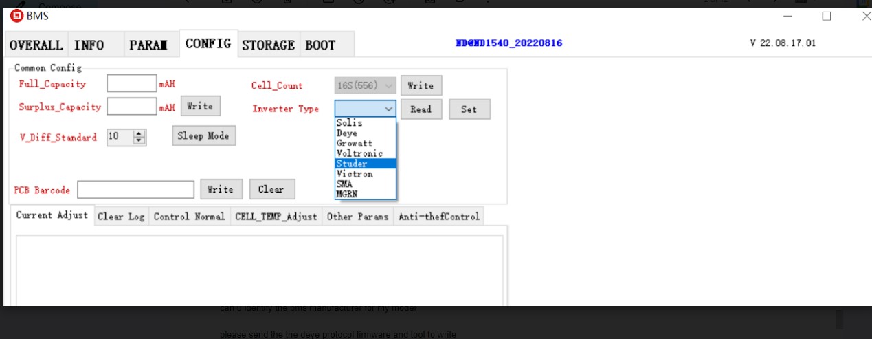

Bought another cheap Narada but had issues with the communication software. Tried a few others ... To found out that the EG4 lifepower4 monitoring software (BMS test) also works.
Available here :
https://eg4electronics.com/wp-content/uploads/2022/08/BMS-Test.zip
2023-01-23 20_42_23-BMS_Test_V1.0   -------   Copyright @ Qualtech Technology Co., Ltd. All rights r.png

Do you have this software, can you share it with me?
