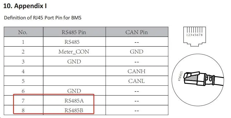

Regarding the RS485 port, it seems to be present only on the 5kW models with that label and is for energy meter comms. On the 8kW model it is called Meter_CON. Who knows whether it would ever support Modbus queries the way we want it to.
5kW Deye:
8kW Deye
A different avenue that I would like to explore given time (which is scarce) is using the CAN port of the inverter to communicate to the Narada battery by converting the CAN bus comms to what the Narada battery expects by using a Raspberry PI. I have an RS485 CAN HAT which can do both RS485 and CAN bus. The idea would be for the PI to act like a CAN-compatible battery to the inverter and it would in turn speak to the battery via RS485. I think it would be something similar to this. At this point though it is purely speculation on my part that it would work for the Deye/Sunsynk and Narada battery combo.

My issue is that the inverter does not speak to the battery with Lithium mode 16 no matter what combination I try. I’ve tried (arranged according to A/B RS485 signals):
  1. Inverter pins 2,1 to battery pins 2,3
  2. Inverter pins 2,1 to battery pins 7,6
  3. Inverter pins 7,8 to battery pins 2,3
  4. Inverter pins 7,8 to battery pins 7,6
All of the above should be valid combinations because pins 2 & 7 and 1 & 8 are joined on the inverter BMS485 port, and the same should apply to the Narada battery pins 2 & 7 and 3 & 6 on the battery side.
Deye inverter:
Narada battery:
I have a single battery and have dried DIP switch positions 000000 and 100000.
Your post made me check the inverter 2,1 to battery 7,6 combo again and I almost kicked myself when I saw that the network cable tester reported that one of the pin combos was not working. I re-crimped the cable several times until I realized that the “remote” part of the network cable tester was faulty and when I tested the cable on the main cable tester unit only, it did check out. So the cable is good and there is still no BMS comms.

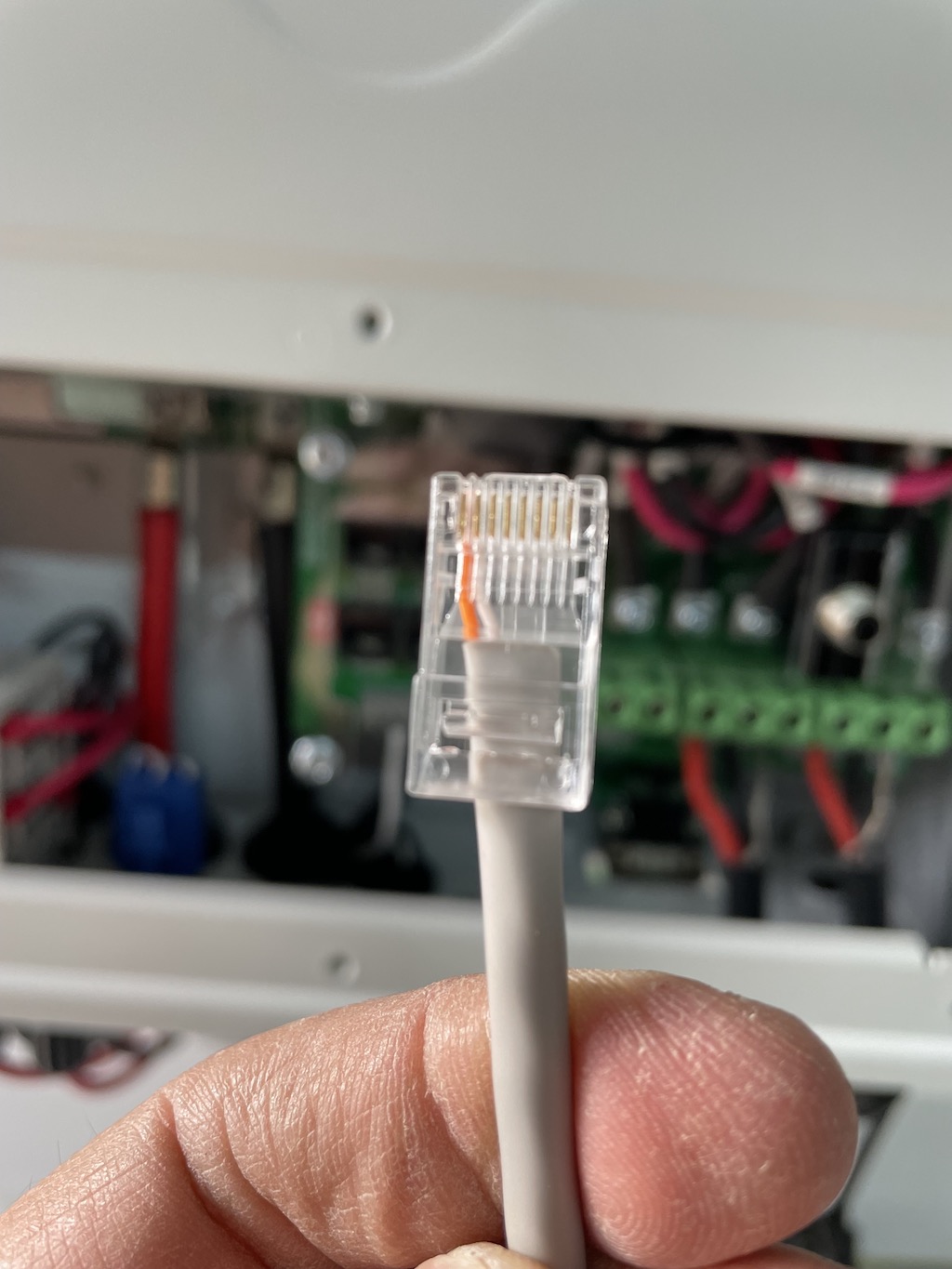

I have a USB to RS485 cable for my battery to ICC / ICM / Solar Assist.... I used a RJ45 wall mount box to a normal crimp to extend this cable and then strand by strand I clipped them until the battery stopped reading in ICM... Reconnected it and then continued to find both A & B cables and confirm that no ground was being used.  This confirmed for me that pins 6 & & were used on the battery side.  From there I crimped it into pin 1 (from ping 6) and pin 2 (from pin 7) for the inverter side and it worked like a charm on mode 16 (on my Sunsynk).
If this is not working, my suggestion would be to try the battery cable to a Pi running one of the mentioned softwares. Confirm that the battery is working. If this is the case, then it would be safe(ish) to rule our battery firmware and then you can concentrate on the inverter side
If you are somewhere close by and dont have the cable / Pi we can test with mine
That is a very smart way of reverse engineering the USB to RS485 cable without ruining it! I thought of buying one of those cables just to verify which PINs it uses for the A/B/GND signals, but you have answered this now. So there is nothing special about this cable? I do have a spare USB to RS485 converter that I can use to test this. I see the Solar Assistant Narada RS485 cables (and software) have been updated “to support the latest Narada batteries released in Q2 2022” - I wonder if the PINs are any different. In any event, I thought of requesting a trial of Solar Assistant (if they do trials) just to see if it is able to read my battery. That would then confirm if the battery firmware is fine or not, like you say.
8 hours ago, SolarConvert said:
Thank you for the kind offer but I am in the JHB area, so quite far away.
Was about to say, yes they do offer trials... No there is nothing special about the cable. I used a standard converter I purchased from Communica - https://www.communica.co.za/products/bmt-usb-rs485-ttl-converter-ftdi?variant=31667841826889
From what I believe, the FTDI chip based ones are better / more reliable

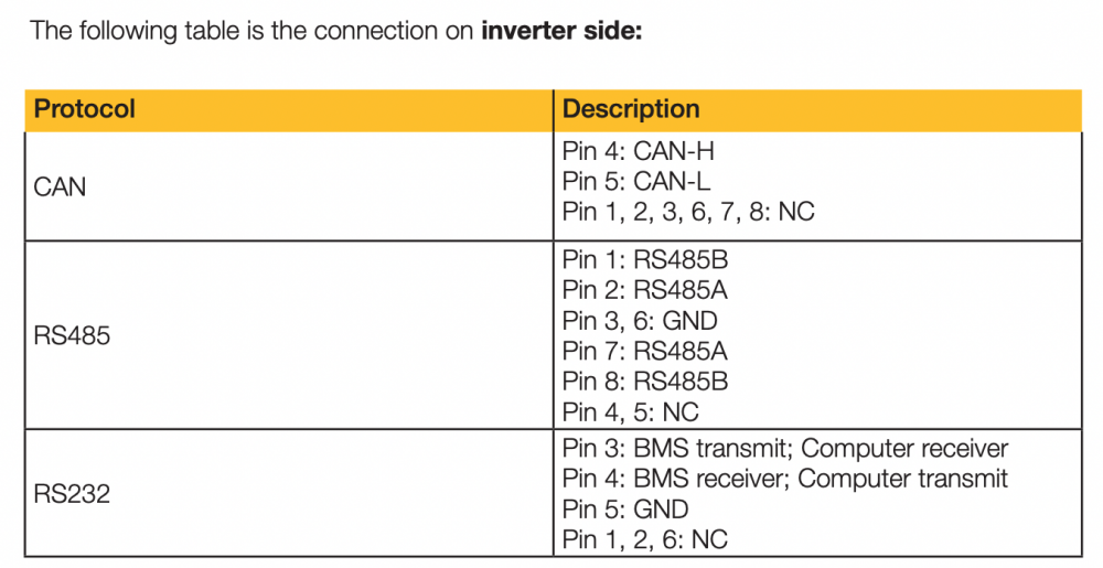

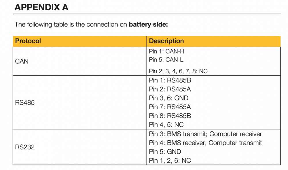

Found something interesting, not that it helps much now but would have origonally... Sunsynk have updated the user manual.
https://www.sunsynk.org/_files/ugd/9350f7_f638285bf3f64db3919aed0c5ff8100f.pdf
On page 46, the Narada batteries have been added with notes for the pins. I think they are looking at the RJ45 plug backwards to me or perhaps the battery supports 2 options mirrored like the inverter
On pages 69 and 70 they have also added appendixes for pin-outs for Inverter and Battery ports
Hope these can help

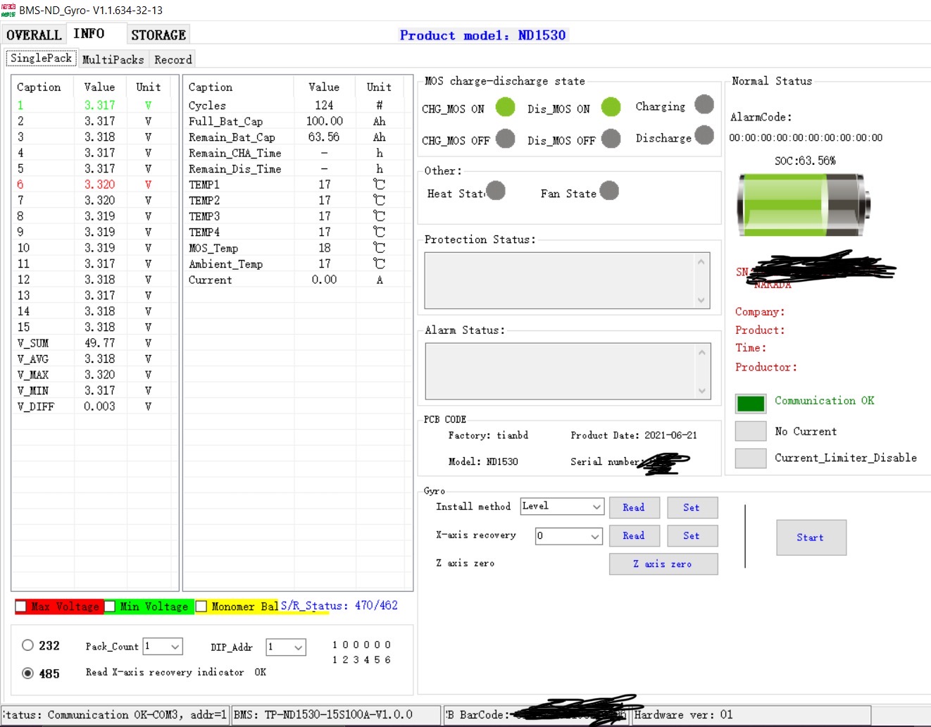

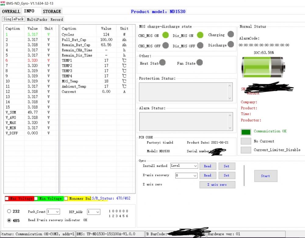

So I have some good news and semi bad news.

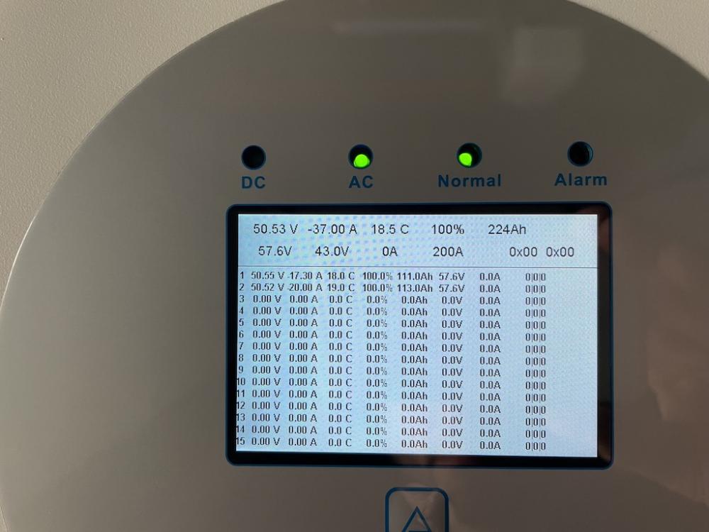

The good news is that Solar Assistant is able to connect to my Narada 48NPFC100 battery BMS and read the values. I noticed that the real SOC read from the BMS can be quite different from what the inverter “estimates” it is - there can be a variance of around 15%! This is why it is crucial to get BMS comms working on the inverter.
Further good news is that I also managed to get hold of the correct software for communicating with the BMS. I am not sure whether this is Shinwa or not, but here is a screenshot:
Baud rate was 9600 and I can confirm all of the usual parameters are correct, eg stop bits, parity, etc. The pins I used were 2 and 3 on the RS485 port (both RS485 ports work). I do think that pins 2 and 3 on the one hand and 7 and 6 on the other are just mirrored on the port.
The bad news is that I still cannot get my Deye 5kW inverter to communicate with the battery using the BMS485 port and Lithium mode 16. At least there is hope though. Either I am overlooking something or Deye simply does not support this BMS (yet). I have crimped yet another cable and using inverter pins 2,1 to battery pins 2,3, and used my network cable tester to verify. I am not using GND. I do reset the battery using the reset switch every time I attempt a new combination (I did this during load shedding at night and caused an outage at my home, unhappy wife, etc).
I am still hopeful that I can get this to work and will send Deye support the above details. If anyone else has gotten their Deye inverter to speak to their Narada battery with the BMS in the above screenshot (TP-ND1530), please let me know!

By the name TP-ND1530 & the look of the software, chance is it's not a Shinwa but a Tian Power BMS.
I should have some info somewhere from the time I was looking for the software before getting it from Narada ...
That looks promising, care to share the software with us?
2 hours ago, zivva said:
Revov is using Tian BMS on some of their batteries.
You could try the setup attached ...
Looks like it may well be a Tian Power BMS! I am really impressed with how you identity multiple BMS types :)
I tried using Lithium protocol 9 and was really surprised when I saw the real SOC coming through on the Deye inverter! I could almost not believe it. However, the battery temperature was reported as 330℃, so obviously the data was not all correct. Whilst I was looking at the other values, BOOM, lights out, wife unhappy again! Yeah I shouldn't have tried this again during a grid outage. I didn't learn my lesson the first time. The inverter disconnected from the battery and reported error F51 (W phase grid current DC component over current). Apparently this error has never happened so far according to the Deye manual. It took me a while to switch settings back to not use Lithium mode at all, for the inverter to reconnect to the battery and for me to calm the wife. I mean come on, why won't she understand that getting BMS comms working is crucial? 🤔
Anyway, I think I'm done testing for the night. This was progress at least. My conclusion is that Deye/Sunsynk might not support Narada using Tian Power BMS with Lithium mode 16. And yes, don't set it to Lithium mode 9 during a grid outage :)
