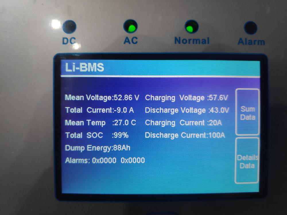

  • Sorry, doesn't work. RS485 works with the 2/3 battery side - 7/8 inverter side cable. Doesn't work with battery set to ID 0 though, need to set to ID 1.
  • @WannabeSolarSparky & @SolarConvert So some great news 🥳.   I got a bee in my bonnet and re-ordered the hardware RS232 splitter (https://www.takealot.com/mt-viki-1-to-4-serial-port-splitter/P
RS485 works with the 1/2 - 7/8 cable.

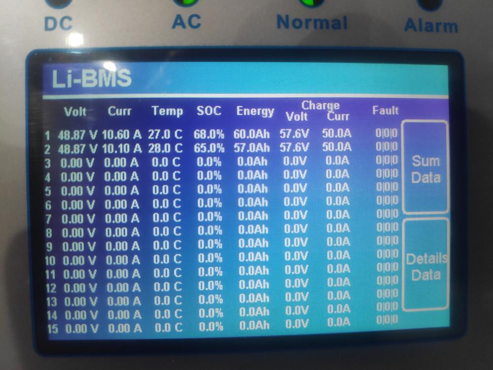

Thanks for the update. Im curious though what details can we see when you tap  "Details Data"?
Not much more than that except when you have multiple battery packs where you see the SOC, current, temperature, etc individually for each pack
Edited by zivva
