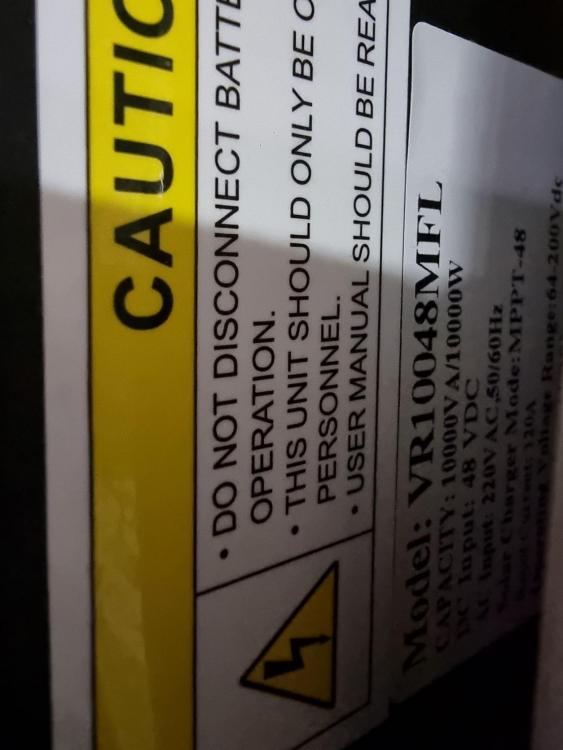

Has anyone managed to get the correct settings for this inverter. I am trying to help my cousin out. He has the same inverter, as per the photos posted, connected to two CFE 5100 batteries.
The batteries keep going into fault. I have logged into the batteries via wifi and the APP, but not picking up any error codes.
Hoping someone has the answer to the settings.

Hi I'm running this inverter in my place I bought it for a customer a few years ago and decided I didn't want to risk leaving it there as the 12v thing concerned me but it is actually designed for old lead acid batteries that were set 4 in series so you could just read the data sheet and set the setting to that. With the modern lithium batterys you need to divide the values by 4
