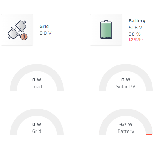

July 5, 20224 yr Hello Nick, Not to forget that your Inverter's internal power usage is not part of what you see as actual power or load. That in itself is typically around ~45 - 60W. When I disconnect my Solar system I can monitor the battery percentage usage per hour and also on the graph I can see the draw from the battery, even though there is zero actual power draw. Pics attached Do you have any battery chargers for example for gate motor or alarm system that regularly recharges the 12V batteries? One way of testing your systems internal battery usage is to disconnect all loads for one night or for a couple of hours if you can, and then check what your SOC is after the no load period. Edited July 5, 20224 yr by zsde
