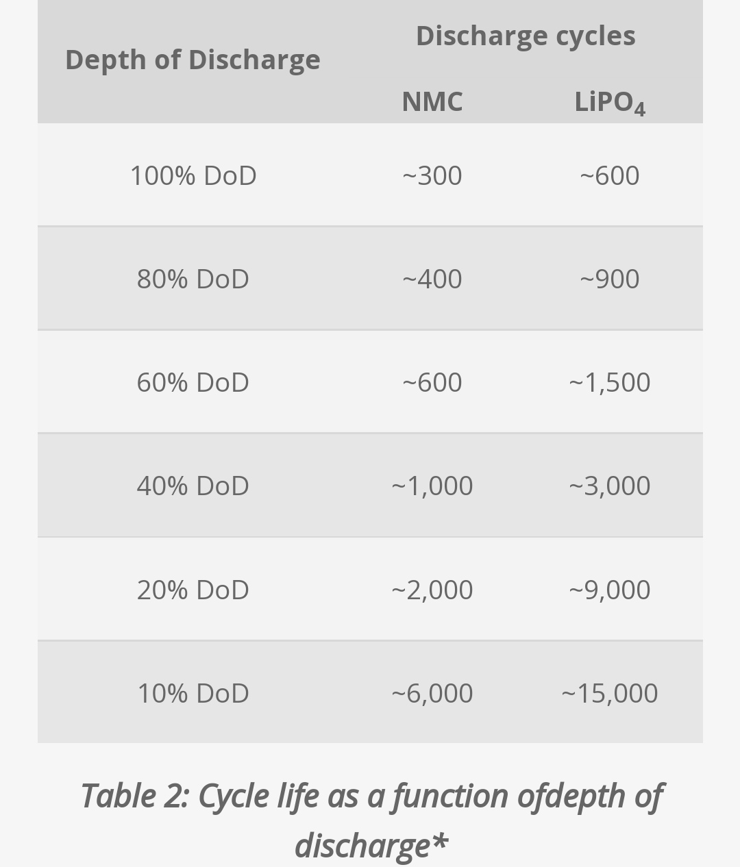

August 3, 20224 yr Manufacturer indicates to charge at 52.5-53.5V Table indicating life cycle. Stick in the 25-85% SOC. Take it up to 100% to allow balancing to take place say every 2 months. Just my guess. Edited August 3, 20224 yr by Scorp007

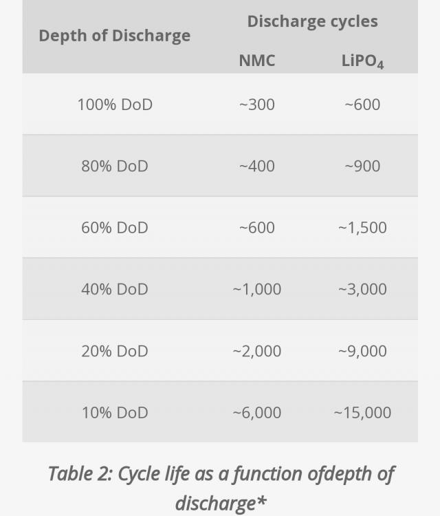

August 3, 20224 yr Author 1 hour ago, P1000 said: That probably voids the warranty, but I would still follow the recommendations - there is probably a reason for it. Im not sure if this invertor can be connected see pictures these are the available ports on the battery and invertor .Can the COM port be used if so what cable will I need and where can I obtain this or if there is anyone around JHB south that can help setup that would also be appreciated.
August 8, 20224 yr On 2022/08/03 at 9:14 AM, Scorp007 said: Manufacturer indicates to charge at 52.5-53.5V Table indicating life cycle. Stick in the 25-85% SOC. Take it up to 100% to allow balancing to take place say every 2 months. Just my guess. I use 80% DoD, so looks like I'll be replacing my Hubble AM2 in 400/365 approx 1.1 to 2.5 years.... 😢 I did a bit of googling, and the number from: https://batteryuniversity.com/article/bu-808-how-to-prolong-lithium-based-batteries seem to be somewhat conservative. See https://core.ac.uk/download/pdf/323272674.pdf https://doi.org/10.3390/batteries7040088 Edited August 8, 20224 yr by system32
August 8, 20224 yr 1 hour ago, system32 said: I use 80% DoD, so looks like I'll be replacing my Hubble AM2 in 400/365 approx 1.1 to 2.5 years.... 😢 Had my Hubble for just under a calendar year now. 359cycles and zero loss in capacity so far. Daily cycle and usage down to 30-40% SOC average every mornings. Have had infrequent 20-30% SOC and also two shutdowns at 20% SOC. So up to now I remain optimistic judging by my usage and the reported values. Edited August 8, 20224 yr by zsde
